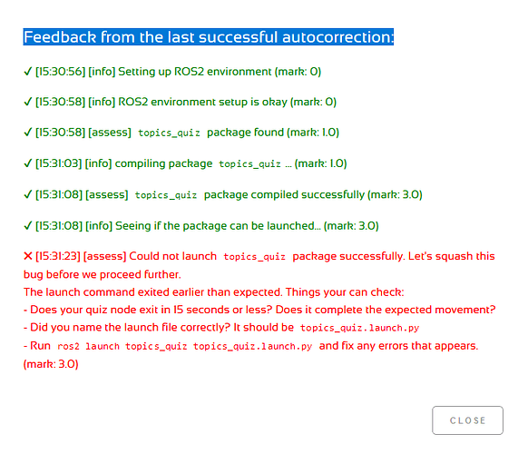

Hey the Construct-Team and robot-enthusiasts,
i trying to solve the topics_quiz but the Gradebot doesn’t want to let me through.
In my opinion, however, I have met all the requirements. Could you help me here?
I don’t get any errors in the terminal or anything like that either. The Turtlebot drives exactly to the specified destination.
Following is my source code:

If you need a video of the programm let me know.
Thanks for your help.
