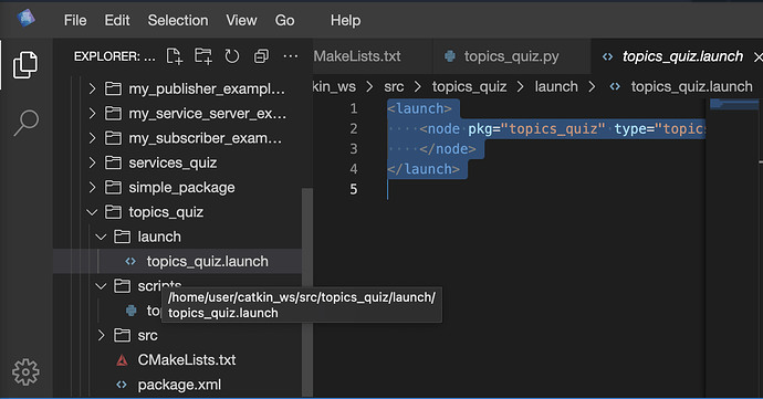

My package structure looks like this
Please also include the screenshot of the grader saying you didn’t pass.
