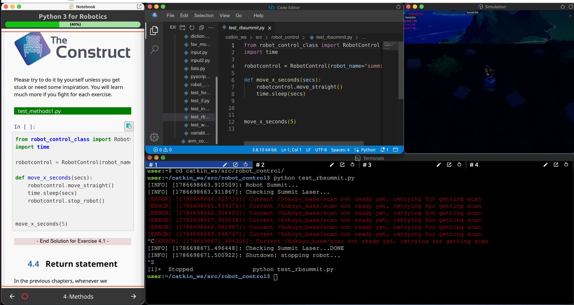

How can i make summit move?
Hi, in unit 4 , I’m suppose i send my command to the new robot summit, but when i try to do so i get a scan error as shown in the picture, it keeps going forever. any idea on what is my mistake ?
the code i used is indicated in the picture as well.

This is the right laser scan topic. Let me check and revert; something is not right.
Sorry about that, we will see into that issue as soon as posisble
Hi, can you show us here your robot_class.py? Becuase you should have this version:

It seems as if you had an older version previous to the update to the new simulations version. This update was done around 1 month ago.
Your issue should be fixed by using the script I provided here. But I would like to know where did you get the other old code, to rule out that we might have missed that code somewhere.
i’m not sure, i have not used this file before,modifying it is not part of my course. this the one i have now :

    self.stop_robot()
    s = "Turned robot " + clockwise + " for " + str(time) + " seconds at " + str(speed) + "  radians/second"
    return s
if name == ‘main’:
robotcontrol_object = RobotControl()
    robotcontrol_object.move_straight()
except rospy.ROSInterruptException:
Thank you this resolved the issue . really appreciate your help.
You have the old version of the script. Did you start this course some months ago? It might have happened that you started it with that version and we upgraded in the middle
yes i started it about 2 months ago.
