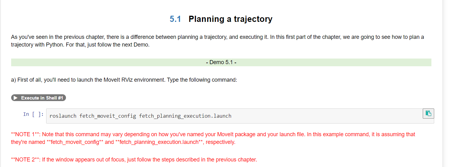

As suggested in the Exercise 5.1, I am stuck in creating fetch_planning_execution.launch file. What content am I suppose to put in this launch file?
Someone please help me in this direction

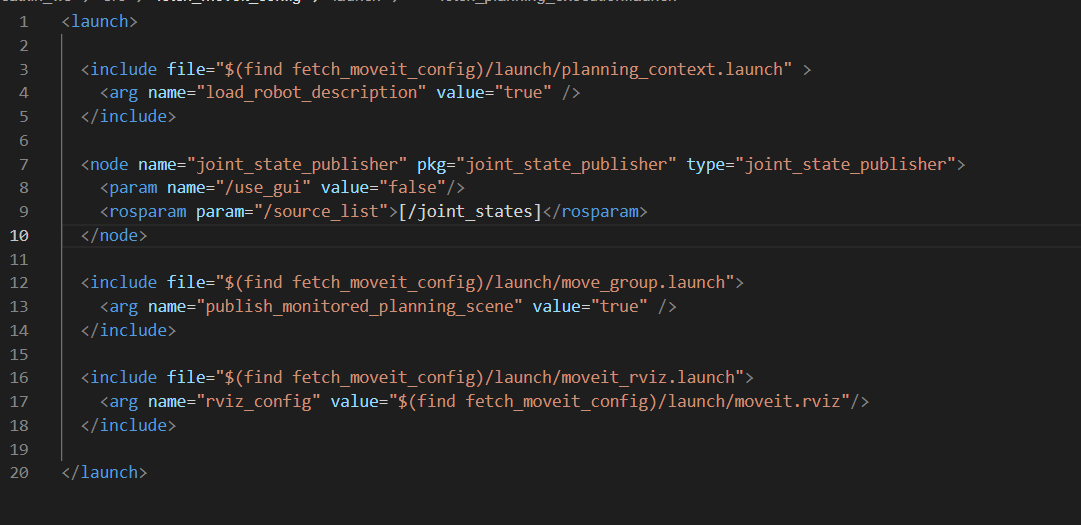

Below is the image of launch file, I have written. After launching this file, the robot is not responding in the simulaation.
Am I missing anything here? Please guide me.
Thanks in advance
Hi @SaiTeja104 ,
The Fetch robot used in the simulation is really slow. Also the chances of it working is a bad probability. You need to restart the simulation a few times so have the robot do some movement.
At the end, the robot will work, for sure. But it just takes some tries, because it is running on ROS1 and MoveIt for ROS1 lacks some features.
This issue is resolved now. I made a mistake while creating fetch_moveit_config package earlier.
I followed step by step to create fetch_moveit_config package once again, and it worked.
