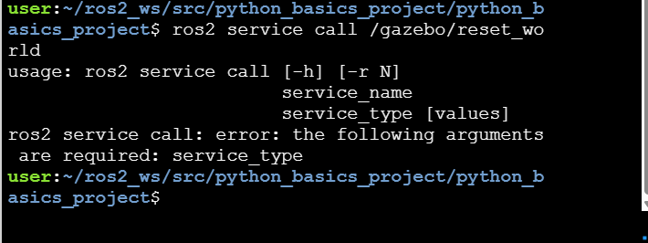

It shows some error. tells to specify service type. Please check the screenshot below
I have corrected the command. Sorry for the miss.

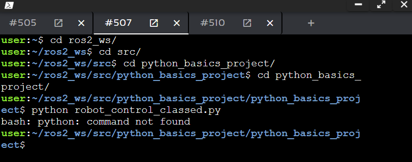

Hello, thanks for the above solution, also I am facing another issue saying python: command not found. I want to run python files directly as part of basic python rosject. How to make python programs run withoput this error. Kind regards,
Try python3 instead of python. If it does not work, please create another post for this.
that works. Thank you …
