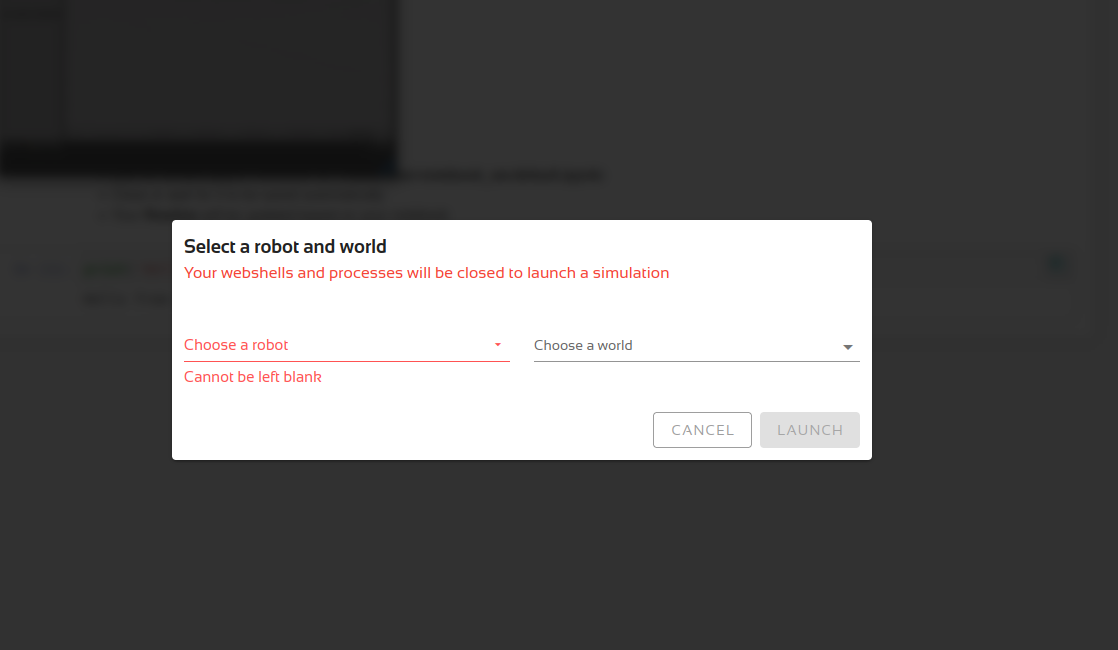

How to select the robot during simulation when creating my own rosject
I don’t know how to select a robot during simulation.
Also, I don’t know what should I do for completing a course? Should I create a rosject for myself and complete its objectives?
Hi @eng.asmaawajeah14, I assume you deleted the post because you figured it out. Let me know if you need more help.
That feature is not working correctly and will be removed soon.
If you select the Humble distro when creating a new rosject, you will be able to select a simulation. Otherwise, you need to create your own simulation. You can find simulations online or use one of our public simulations.
