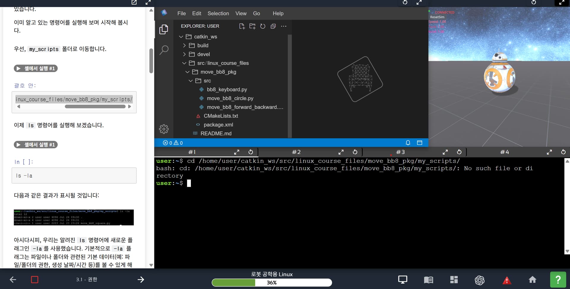

I don’t have the my_scripts folder either. The only folder in move_bb8_pkg is src, which then has 3 python files. Later in the lesson we’re asked to change the permissions for the file move_bb8_square but there is no such file in src.
For the point of the lesson, I intend to simply stay in the src folder and play with the permissions of the files I do have (and change them back to their original permissions afterwards).

Hi I have the same issue and I believe I didn’t skip any step. Since the my_scripts folder is located inside the “linux_course_files” folder, I think it should have been downloaded from the git repo:
git clone Bitbucket
Location of the missing folder:
cd /home/user/catkin_ws/src/linux_course_files/move_bb8_pkg/my_scripts/
However if I look at the git in the Webbrowser there is no my_scripts folder.

I just confirmed that the issue exists. My apologies for the glitch.
I’ll work with the course maintainers to fix this as soon as possible.
In the meantime, we can follow @CaptainSwitz’s approach to working around this problem.
