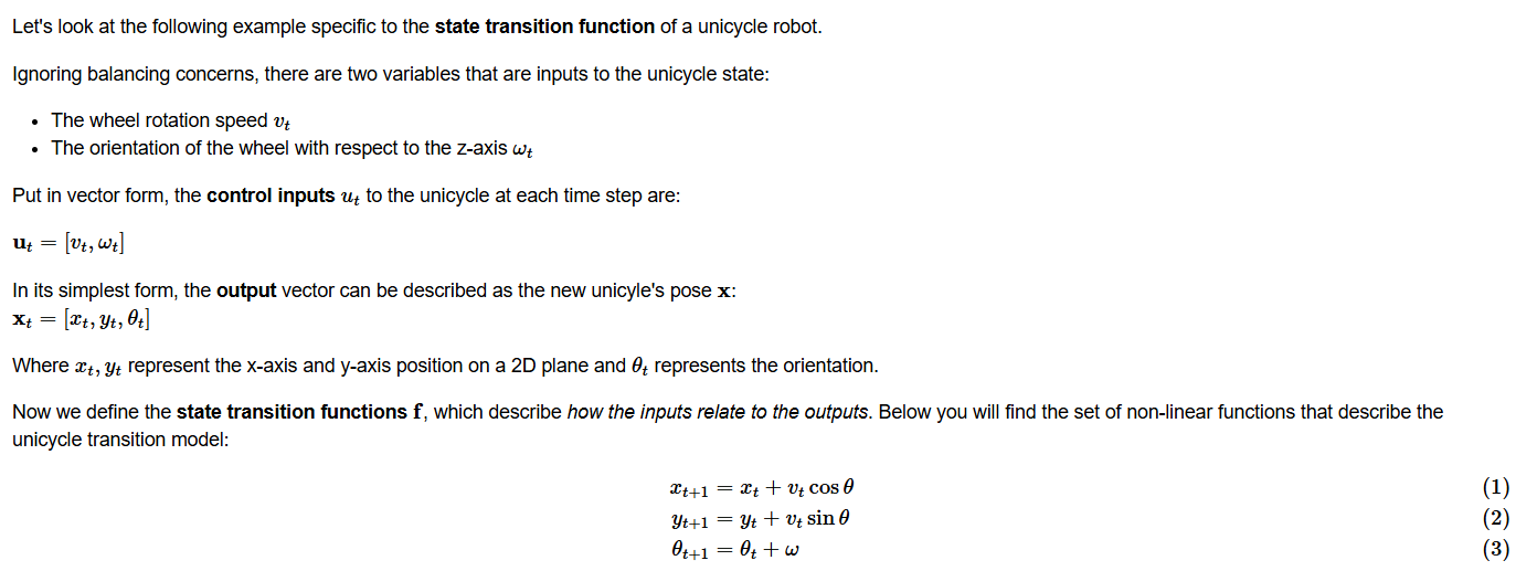

If you see those equations, you are adding xt which is postion coordinate to vtcos theta which a velocity component, how is it possible similarly with rest of the equations…Am I missing something?
zero all other constants and assume vt to be equal to 1, that should help solve for the values you need. Or is that not your question.
Actually What I wanted to ask was vtcos(theta) is a component of velocity hence has the unit m/sec and xt is the position having unit of meters. Now in those equations how are they adding m/sec thing with meters… Dosen’t that dimensionally incorrect @albertoezquerro
