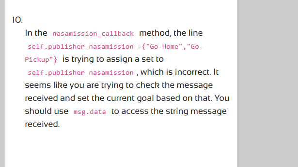

i mean i try to extract the X and Y from the command after someone publishes in the topic /nasa_mission
You should be able to extra the x and y position by studying the message structure. If the message is of type Twist, for instance, and msg is the data published, this could be
x = msg.linear.x
y = msg.linear.y
You should find some examples in that chapter.
