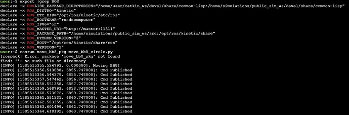

Dear Bayodesegun,
Thank you for you answer!
Kindly see the photo I sent. :slight_smile:
Best regards

Hello, i’ve had the same error, and I’ve run the commands you suggested but the file still runs after changing the path in the environment variable.

As you can see, I’ve changed the path in the environment variable, but when I run the file it works even though it’s not supposed to work.
And finally the output you requested me.
What I can see here is that ~/catkin_ws/src is not included in ROS_PACKAGE_PATH.

Yes, the path is not included in ROS_PACKAGE_PATH because in the last example of unit 3 we are supposed to change it so when we try to run the program the package is not found, but after I do what it says in the course, the program still runs even though it’s supposed to give an error and not run.
