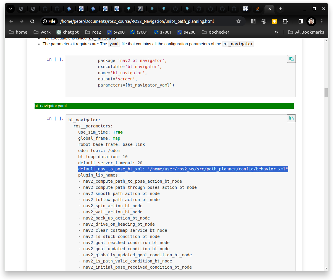

In the bt_navigation.yaml:
default_nav_to_pose_bt_xml: “/home/user/ros2_ws/src/path_planner/config/behavior.xml”
But later the material asks us to create a package path_planner_server, so the bt_navigation.yaml file will contain a bad path for the behavior.xml file.
See here:
You can easily fix it, but I think, pointing to a file in the src directory is bad practice. Also i think, that using hard-coded absolute path is fragile, so I looked for a better solution.
