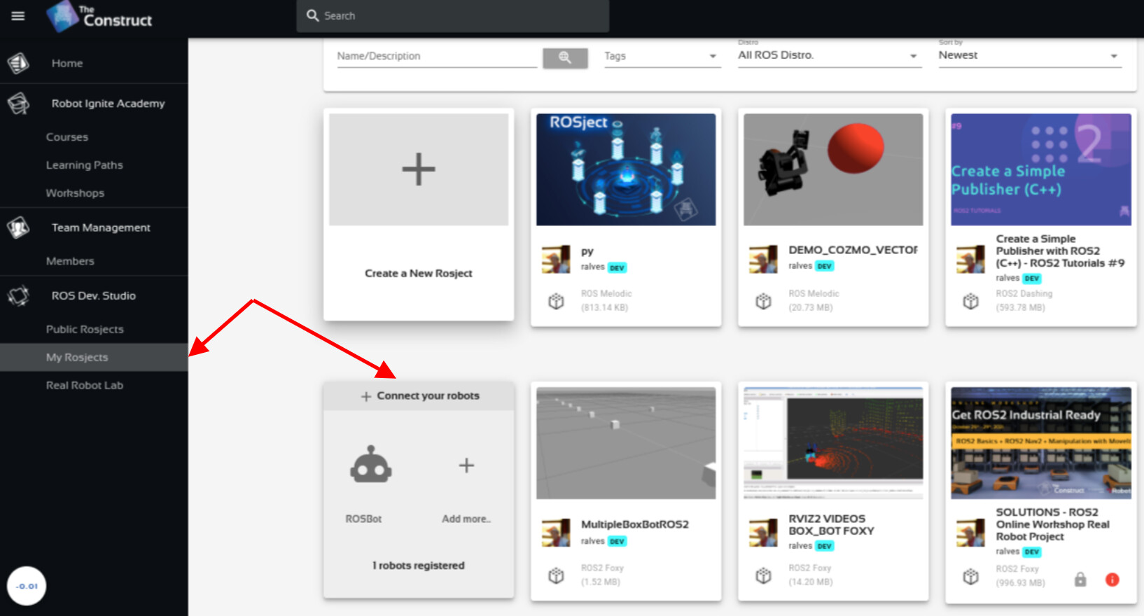

If what you want is to easily connect to your robot, in The Construct we have also the Real Remote Lab. You can setup your own lab in the My Rosjects area.
