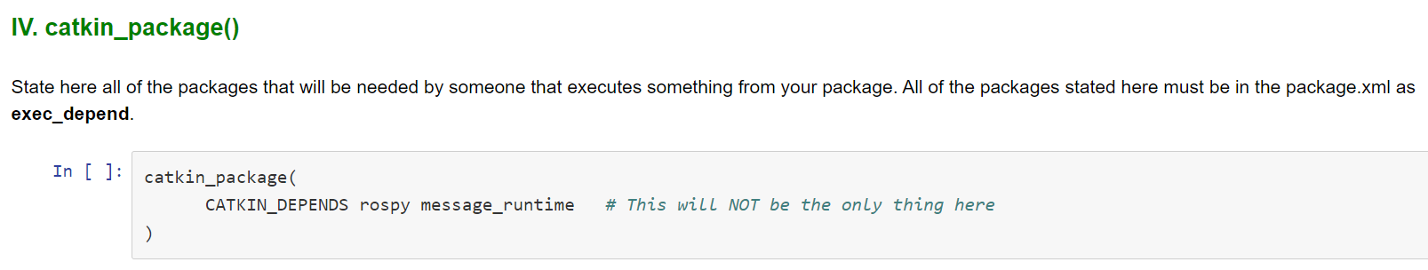

sorry sir
i followed this step and i got confused with this comment “This will NOT be the only thing here”. and i thought that catkin_package() can have all the packages, so thats why i didnt edit anything from this catkin_package().
Thanks for your time and response sir :slightly_smiling_face:
Hi @AshishVarma ,
Ah, I see. I now understand your confusion.
The other 3 lines in this function is for advanced package creators.
For the basics you require only the CATKIN_DEPENDS line.
