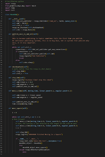

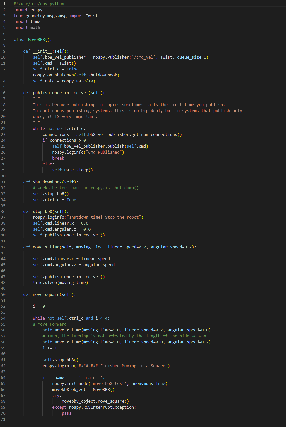

While learning Linux essentials, I encountered an indentation error while executing Exercise 3.1 . I resolved the issue by correcting the indentation in the script. However, after fixing it and running the script again, my BB8 robot is not moving at all. The terminal isn’t displaying any errors either. I’ve attached an image of the updated code after fixing the indentation. Could you please help me identify what I might be doing wrong?
We have checked that the code in the course is correct.
Please, go to Unit 2 and search for the code of the move_bb8_square.py script and copy again and paste it agin in your file, replacing what you already have in it.
Then it should work
Thank you, I did some mistake while fixing indentation error. Now, code is working.
