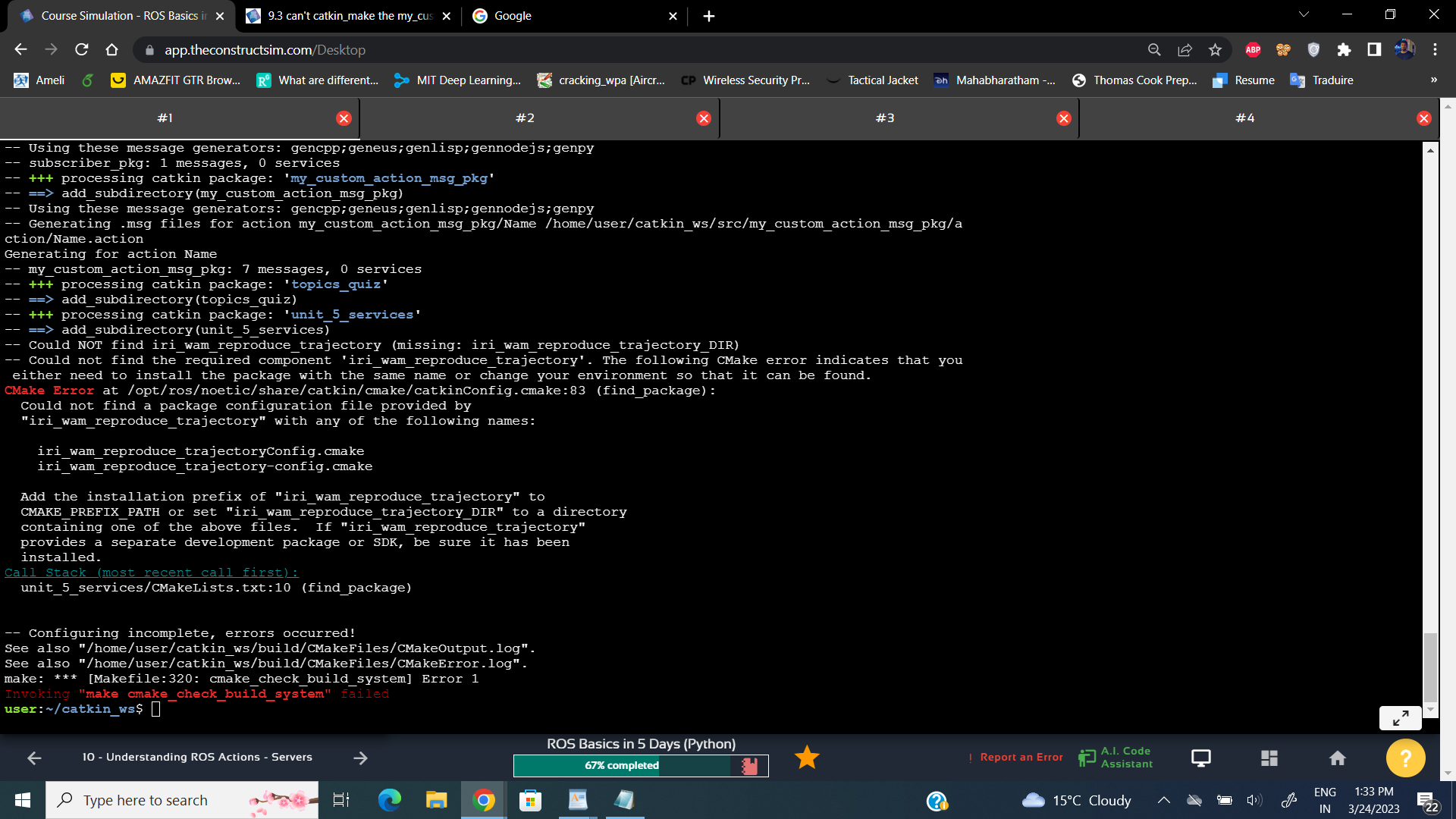

Hi @girishkumar.kannan @bayodesegun ,
I face this error in creating my custom action file. I check my ros install directory the “/noetic/share/rospy/cmake” is present but I don’t why catkin_make can’t find the msg path. Any help would be highly appreciated.

The error msg in terminal
I am really lost like why does get error in unit_5_services/CMakeLists.txt:10 (find_package) and what that has to do with the current pkg am working

Hi @balajigunasekeran22 ,
Please check your unit_5_services
package. In the CMakeLists.txt
file of that package, make sure you have included iri_wam_reproduce_trajectory
package like below:
rospy
That should (probably) solve your problem.
Also, I think you are using catkin_make
instead of catkin_make --only-pkg-with-deps <pkg_name>
Let me know if your issue is solved.
Regards,
Girish
Hello @girishkumar.kannan ,
Thank you for the reply. I solved the error for Name.action and the “rosmsg list | grep Name” shows me the expected results. However in this unit_5_services I have already included iri_wam_reproduce_trajectory but I don’t why that I shows errors only now and Not while I was in that package. Does this has anything to do with my deletion of the devel and build folder as it did to solve the error in Name.action
If you deleted your build
and devel
folder, the very first compilation after the folder deletion must be
catkin_make
only - to build all the packages at once. You can also use --only-pkg-with-deps
but that is only when you choose to compile packages individually.
But you must build your custom message package before compiling the package that uses the custom message package.
Hope this helps.
Regards,
Girish
Besides what has been added by @girishkumar.kannan (that you can use catkin_make --only-pkg-with-deps <pkg_name> instead of catkin_make), I know that sometimes it is easiar to launch the smaller command even though and compile all packages (even though it may incur in spending more time).
In fact, sometimes problems related to past packages can influence the compilation of the current package and in this case you were correct in trying to delete “build” folder. You may have noticed that in this case new logs are presented in your bash.
In your specific case, another solution would be simply temporarily commenting that line in the CMakelists.txt. For compilation of the package you are interested now.
