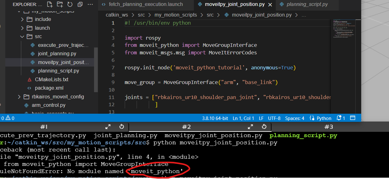

I am trying to execute exercise 5.7
I have copied the same code and executed it.
I got the following error: ModuleNotFoundError: No module named ‘moveit_python’
Am I missing anything here? Please guide me

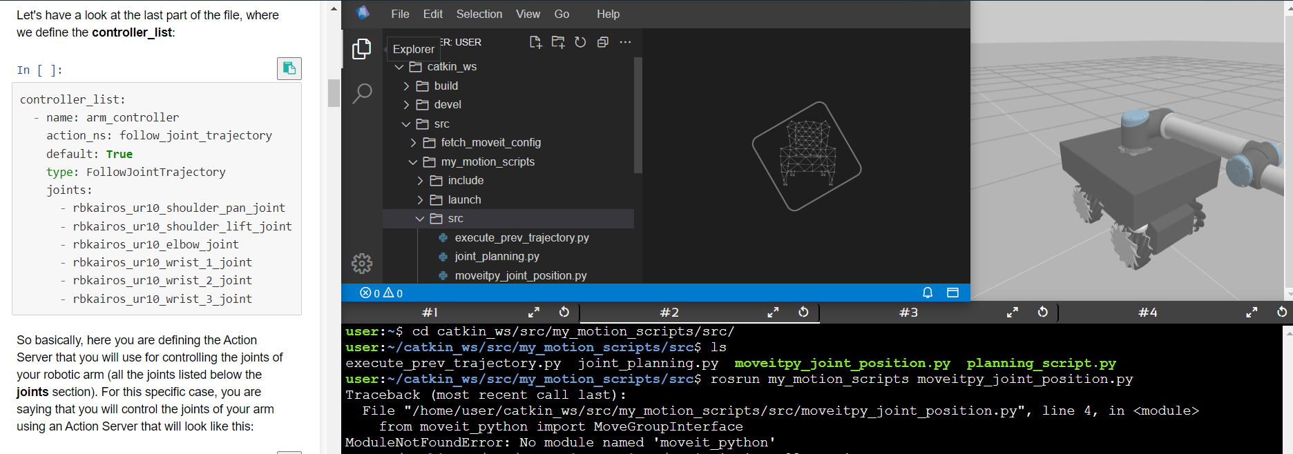

Hi @girishkumar.kannan
I’ve tried running the executable using rosrun command. Unfortuantely, I am facing the same error. I am trying in implement this for rbkairos robot in unit 4, not the fetch robot in unit 5.
Is the error because of that?

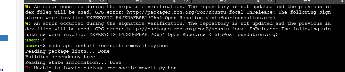

Thanks for your response. I tried installing move_it python dependency but could successfully rin the command.
I have attached the image for your reference. Could you please guide me here.
Hi @SaiTeja104 ,
I am assuming that the ROS1 version installed in the course is older than noetic.
So follow the steps below to install the proper version of moveit_python:
  1. Check available ROS1 versions installed on your course environment:
    cd /opt/ros && ls
  2. You should see the installed ROS versions like below:
    crystal foxy galactic kinetic noetic
  3. Now choose the most recent ROS1 version (I am assuming that will be kinetic).
  4. Now install the moveit_python and moveit_commander packages for your ROS1 distribution:
    sudo apt update
    sudo apt install ros-kinetic-moveit-python
    sudo apt install ros-kinetic-moveit-commander
These steps should fix your issue.
