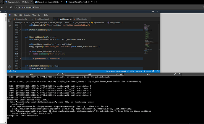

Node not killed when an expcetion raised inside a timer_callback()
  1. Normally, when the node has an exception, the node will die, shutdown,. …
    But when I raise an exception inside a timer_callback(). The node is not dead
Why? Please help
  1. I want to use respawn=“true” in a launch file to respawn a node if there is an exception while the node is working. The exception raised but the node is not dead → The node can not respawn.
Do you have any suggestions for this problem?

It’s because timer_callback is running in a separate thread. This is indicated in the image you attached:
Exception in thread Thread-x
Only an exception in the main thread would stop the node.
Raise the exception in the main thread when the condition is met. You could change your code as follows:
