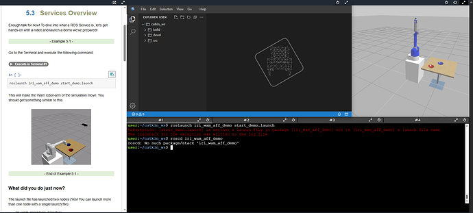

Thanks a lot @bayodesegun ! this command finally fixed the issue.
the only thing is that now the simulation runs on a different path: /home/simulations/public_sim_ws/devel and if i run roscd it comes back to this path instead of catkin_ws. is it normal?
if I come back to /home/user/catkin_ws and i try to run
roslaunch iri_wam_aff_demo start_demo.launch
I get the same error as before:
RLException: [start_demo.launch] is neither a launch file in package [iri_wam_aff_demo] nor is [iri_wam_aff_demo] a launch file name The traceback for the exception was written to the log file

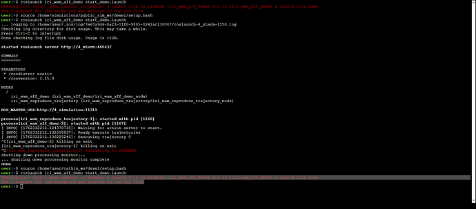

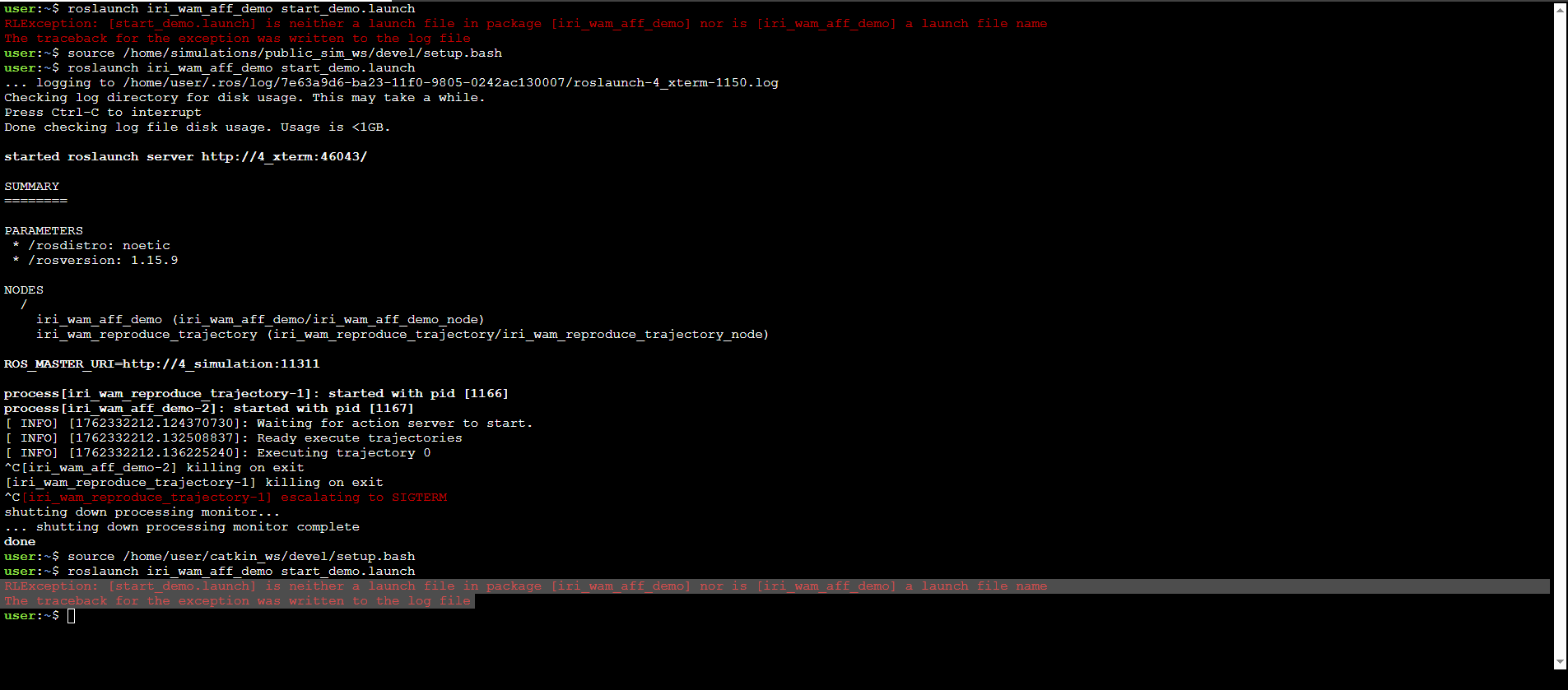

how you can observe from the shell, if i run:
“roslaunch iri_wam_aff_demo start_demo.launch”
after sourcing in “source /home/simulations/public_sim_ws/devel/setup.bash” it works.
But if i run the same command from “source /home/user/catkin_ws/devel/setup.bash”
it prompt the same error:
“RLException: [start_demo.launch] is neither a launch file in package [iri_wam_aff_demo] nor is [iri_wam_aff_demo] a launch file name The traceback for the exception was written to the log file”
That seems normal, as far as I know. ROS attempts to locate the package in the “current” (most-recently sourced) workspace.
