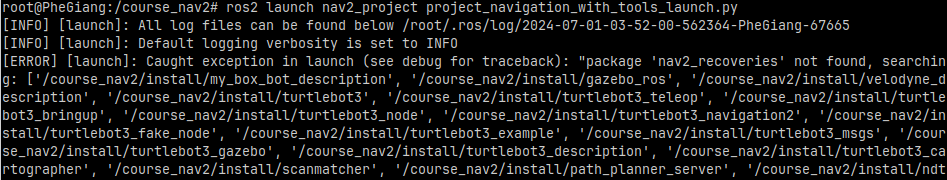

Package 'nav2_recoveries' not found
I have problem with path planner excercise.
I tried run ros2 pkg list | grep nav2_reco
But ouput is nothing
Below is my file launch:

I’m using Humble distro
Hi, nav2_recoveries is deprecated in Humble.
The package that accomplishes the same is now named nav2_behaviors.
I have confirmed that this is the package name specified in Unit 5 instructions:
        Node(
            package='nav2_behaviors',
            executable='behavior_server',
            name='recoveries_server',
            parameters=[recovery_yaml],
            output='screen'),
