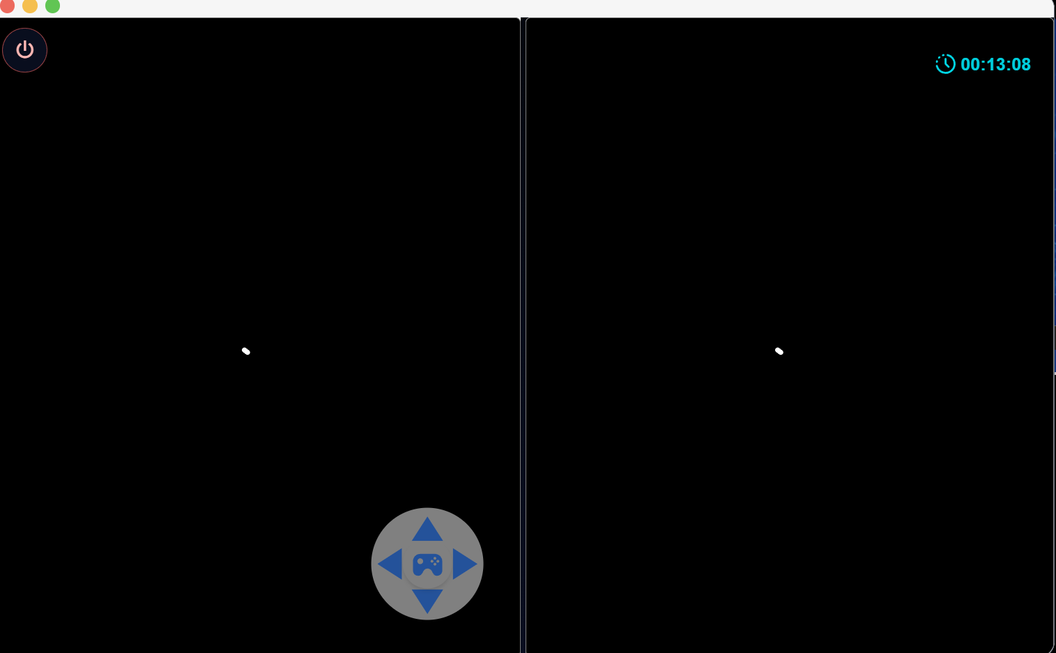

Thank you for that. I have another issue where the cameras are not streaming, they are just buffering, so I cannot see footage of the robot.
@albertoezquerro
Please check again. The cameras are up now.

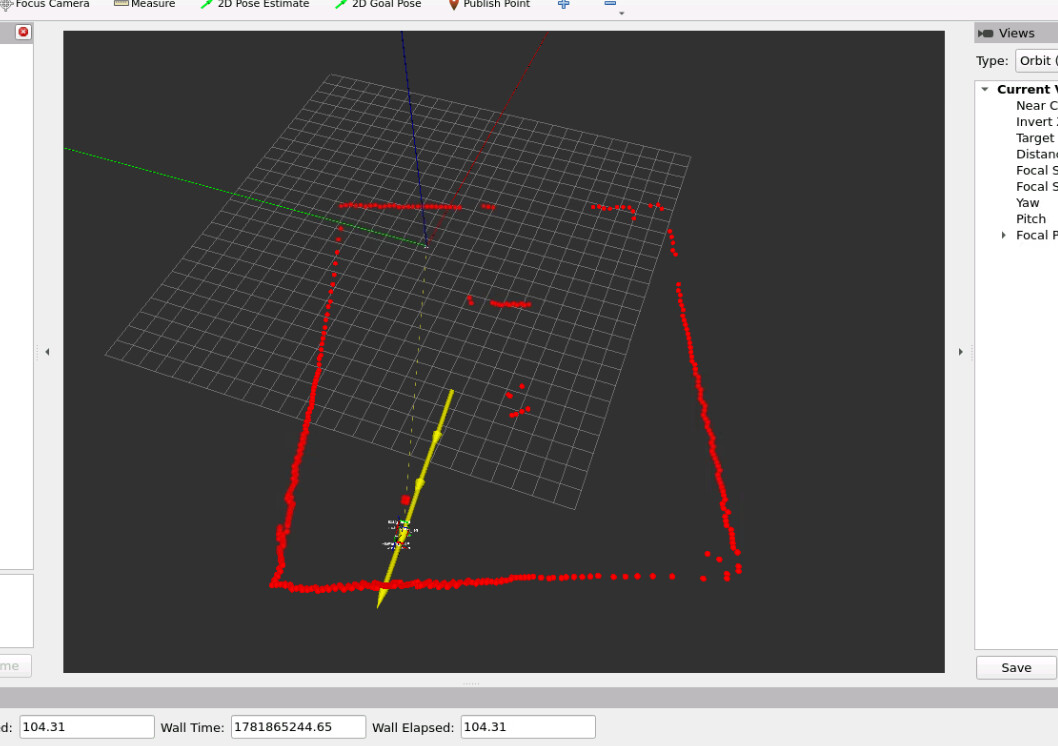

Hello, the buffering is still present on the cameras. I also tried running the obstacle_avoider.bash script on the robot and the robot seems to be responding to the forward moving commands (based in what I can see on the robot visualiser) but not the left and right turn commands. I tested my code on simulation and it was working (i.e., the robot was going forward, left and right on simulation).
Hello @janimahmood22 ,
There was an issue with this lab cameras that should now be fixed. Please let us know if it’s working correctly for you the next time you access the lab.

Hello, the camera does work now thank you very much. I am having another issue if you wouldn’t mind helping me with it. The robot can go forward but cannot go left or right even though the command is being issued based on the debug messages I receive from the code. I have also attached the obstacle_avoider bash file that I have been using below. I would really appreciate it if you could help me with this.
