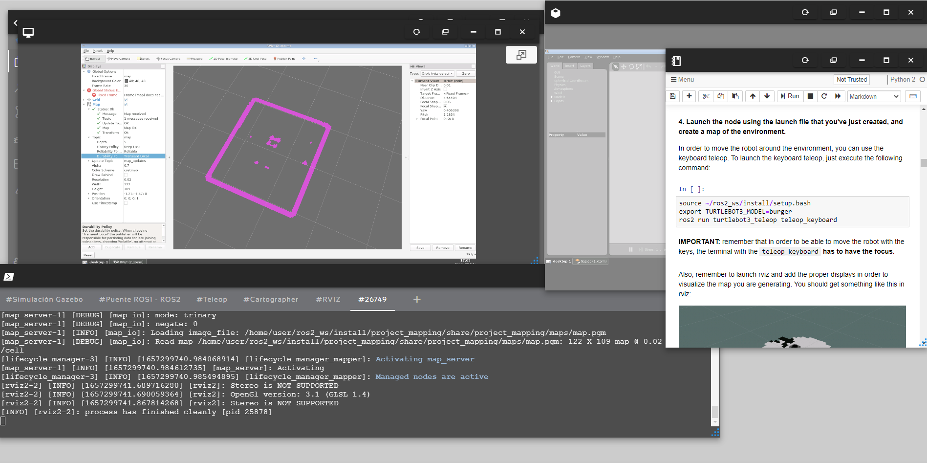

Greetings, I’ve just started with the chapter 1 of the project from the new ROS2 Navigation course, and already managed to build a map, but the problem is that it doesn’t show the obstacles in the middle, it only sees the walls of the simulation.
Also, I have many questions about TFs in this case, here as it can be seen I have as Fixed Frame the frame map, where I cannot see the obstacles, but neither I can see a LaserScan if I add it. If I switch to base_link I stop seeing the map but the LaserScan works, where I can see the obstacles, as shown in the next picture:
