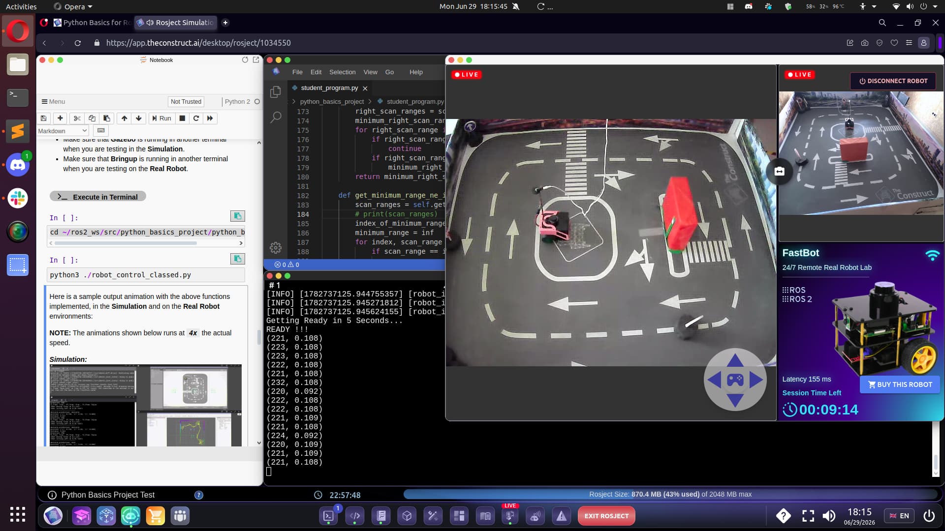

Hello, I was trying to figure out which laser index corresponds to the front, back, left and right and I was doing it by orienting the robot so that the front of the robot was close to the wall and reading the minimum distance measured and which laser index it corresponded to. I repeated this for left, right and back by orienting the robot such that the left, right and back are closest to the wall and seeing the laser index with the minimum distance. This worked in simulation, however, in trying this with the FastBot, I got the same laser index with minimum distance regardless of the orientation of t he robot which I believe should not be possible if different directions of the robot (and therefore different laser indices) are closest to a wall. I have attached my code below if it helps. I would appreciate any help regarding this.

Hi @janimahmood22 ,
Thanks for reporting this issue. I personally connected to the robot and tested the laser scan values myself.
It seems to be a problem with the robot’s laser scan. It reports a faulty value. I think the laser scanner needs to be replaced or fixed by hardware replacement.
Here is a screenshot that I took, showing the error: there is no object about 10 cm around the robot and it reports that one index above 200 is having a value about 10 cm.
Now that this issue is detected, it still does not stop you from proceeding with your program.
The fastbot dimensions are 15.5 x 15 cm, that is, left to right is 15 cm (wheel to wheel), and front to back is 15.5 cm.
The laser scanner is situated in the geometric center of the robot, so you have front and back distance minimums as 15.5/2 = 7.75 cm, left and right minimums as 15/2 = 7.5 cm.
So when you are doing this experiment again, make the robot go close enough to the wall, but not touching the wall, essentially having more than 15 cm gap between the laser and the wall.
this way, you can also exclude any values under 15 cm, and check for the range closest to 15 cm, just above 15 cm on all 4 directions. Then you can get the indexes that correspond to the directions of the robot.
But yes, the laser scanner is faulty on the robot for sure. But for this small anomaly, the laser scanner cannot be changed. I hope you understand this fact. Please proceed with your project with the suggestion I have provided you above (exclude values under 15 or 12 cm).
I hope this solves your issue.

Hi @janimahmood22 ,
I just realized something - the one index that always shows close to 10 cm is not the fault of the laser scanner.
It is the result of the robot construction - the antenna pole on the back of the robot is the culprit here.
So you will always have 1 or two readings that give a fixed constant low value.
Yet again, the workaround is to ignore the values less than the distance to the antenna pole, which is oscillating around 10 cm.
Your solution: just consider all values above 12 cm and under infinity.
This should fix your problem.
Also, considering the fact that there will be loose wires hanging about on the back of the robot, my recommendation here is that, it is best not to use any laser readings from the back of the robot for navigation purposes.
