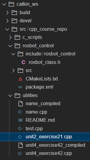

As you explained, I added the -I in the command, along side with the directory, which gives me the follwoing command line:
g++ -std=c++11 unit2_exercise21.cpp -I /catkin_ws/src/cpp_course_repo/rosbot_control/include/ -o compiled
My folder having the follwing architecture:
The line of command was unsuccessful (I tried a few variations for the path, here is one)
What did I do wrong ?
Thank you for your time

Hi @gui.d ,
the path to catkin_ws is wrong.
Rather than
You have to use either:
~/catkin_ws/src/cpp_course_repo/rosbot_control/include/
or
/home/user/catkin_ws/src/cpp_course_repo/rosbot_control/include/
If you don’t understand this point, please take the Linux course that is freely available in our platform.
