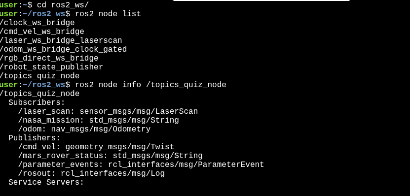

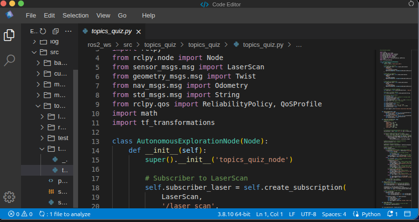

Here are the logs. You can see that I did create the topics_quiz_node, both in the logs and in my code. You can also see that it’s subscribed to /odom.

The correct way is to launch your quiz and check which nodes are subscribed to scan the topic . After checking this point, please check the hint below.
Hint: What did you name the node in other places besides your topics_quiz.py?
THks for your help. The issue was that I had two subscribers with the same name, my mistake.
