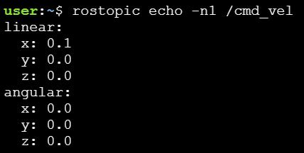

If you can look at the screenshot, you can see the /cmd_vel topic correctly gets the command to move. However, the robot does not move. When I try to use teleop it says “waiting for subscribers”.

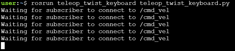

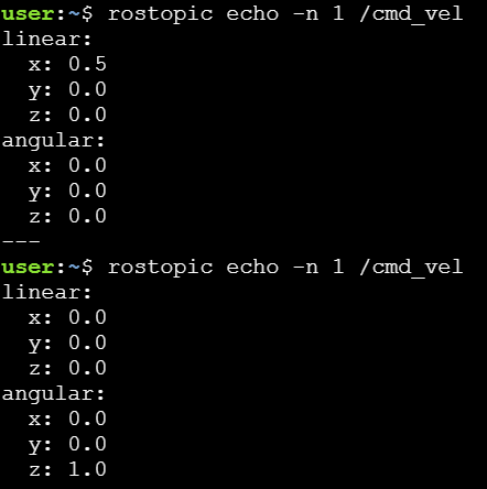

So, teleop found its subscriber and started publishing, but the robot will not move. I run teleop on terminal 1 and rostopic echo on terminal 2. When I press “i” and “j” I get linear.x and angular.z respectively in echo. But the robot does not move.

I have connected to turtlebot in real robot lab and receiving live video feeds. When I try to move the robot with onscreen joy stick, it does not respond. When attempting to move the robot through terminal, by using teleop_twist_keyboard.py, it returns a msg saying Waiting for subscriber to connect to /cmd_vel. I have attached screenshot,

When using teleop, it keeps repeating “Waiting for subscribers”. It only starts when I rostopic echo on the other terminal. Could this mean that the robot itself is not subscribed to the topic?
