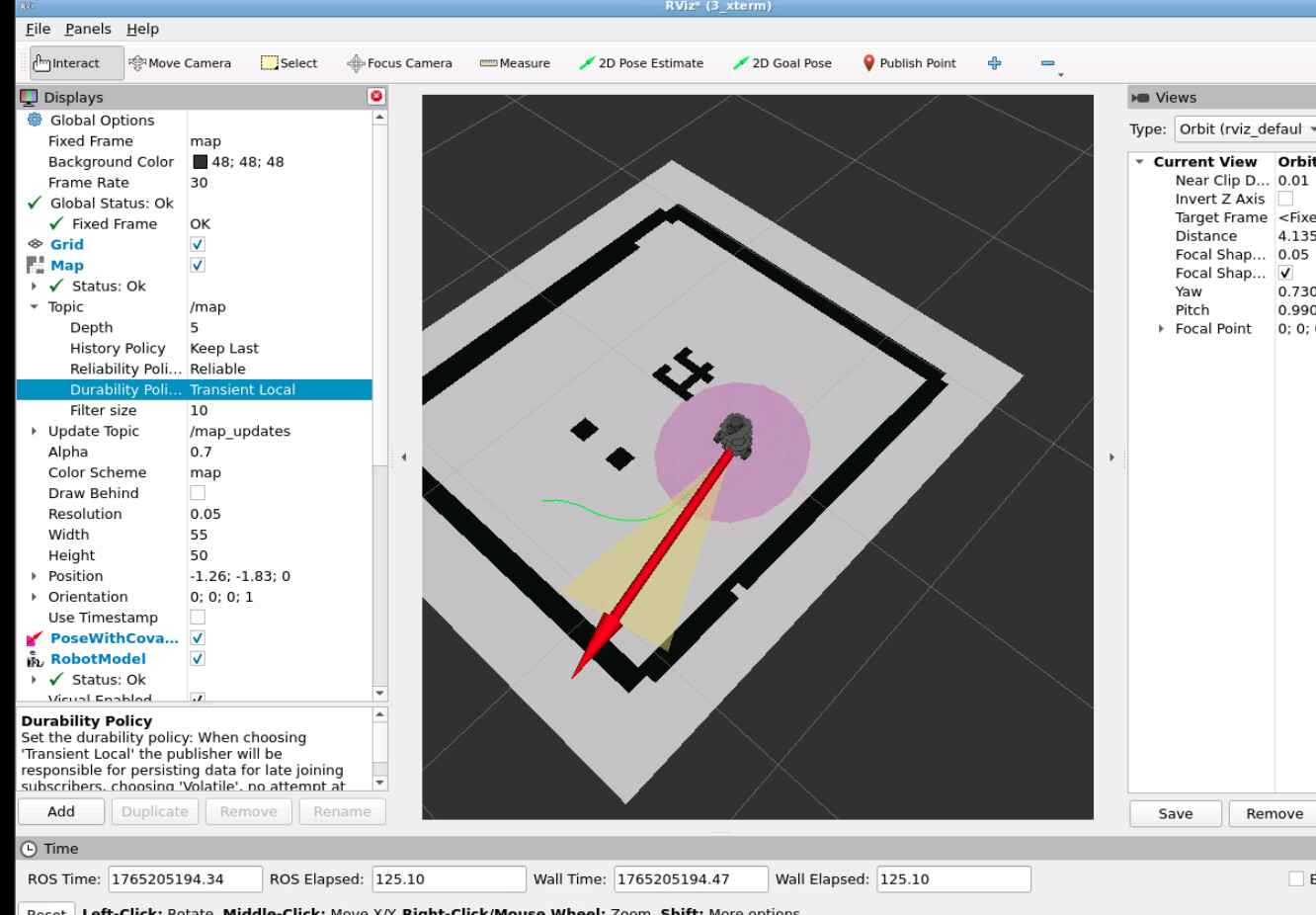

Hi @staff in the project I am not being able to make the robot follow the planned path, and I am wondering why. I was able to:
A) Start Nav2 successfully (planner, controller, behavior, lifecycle manager, costmaps)
B) See the global plan in RViz (green path from robot to goal)
C) See the local costmap and obstacles correctly
However, the robot does not follow the planned path.
Sometimes it slightly rotates, but in general it stays almost still and I get “Failed to make progress” and “control loop missed its desired rate” warnings in the controller_server logs.

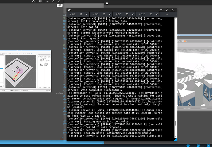

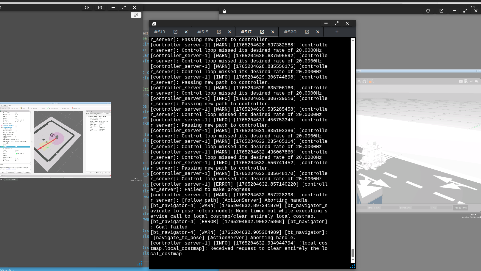

From controller_server:
[controller_server]: Control loop missed its desired rate of 20.0000Hz
[controller_server]: Passing new path to controller.
[controller_server]: Failed to make progress
[controller_server]: [follow_path] [ActionServer] Aborting handle.
[local_costmap.local_costmap]: Received request to clear entirely the local_costmap
From bt_navigator and planner_server:
[bt_navigator_navigate_to_pose_rclcpp_node]: Timed out while waiting for action server to acknowledge goal request for compute_path_to_pose
[global_costmap.global_costmap]: Received request to clear entirely the global_costmap
[planner_server]: Planner loop missed its desired rate of 20.0000 Hz

Hello @marcusvini178 ,
If everything seems to be correct (no error messages in the logs) but the robot is not able to follow the planned path, a possible reason might be that Nav2 (controller server) is sending the velocity commands to the wrong topic. By default, these commands are sent to the /cmd_vel topic, but maybe your robot uses a different topic for this. In this case, you would need to remap the output of your controller server.
Let me also suggest adding the costmaps to RViz so that you can easily visualize them and make sure those are not the ones responsible for the root not moving. An inflation layer too big could also prevent the robot from making any progress.
