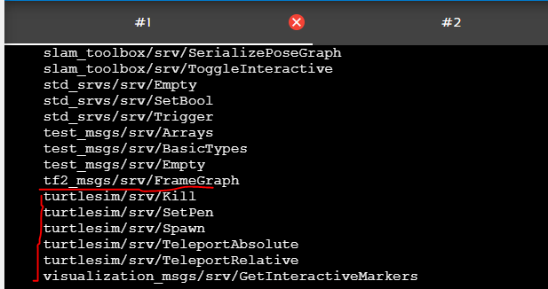

Could you show the results of a ros2 interface list | grep services_quiz_srv please? If Turn.srv does not appear there, I do not know how to help you.

Now, you can list the messages/interfaces available with:
ros2 interface list
You should see your message in the list of services.

No /turn here
Also no /age

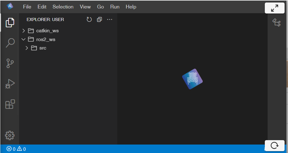

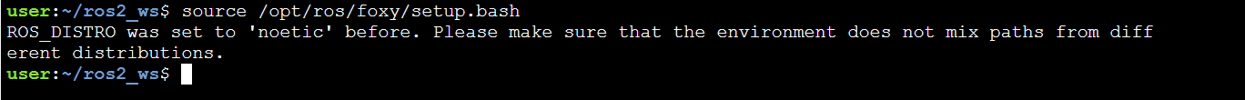

It looks like you have a problem with your sources mixing ROS1 and ROS2.
Try this to clean everything:
  1. Go to ~/ros2_ws and delete build, install and log directories
  2. Restart ALL the terminals (by clicking on the red cross icon of EACH terminal)

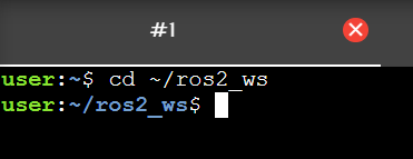

  3. On one of the restarted terminals, go to ~/ros2_ws
  4. Source /opt/ros/foxy/setup.bash
  5. Recompile the ros2_ws
This should have generated a new fresh code which only sources ROS2.

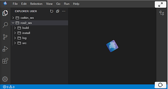

Here are the step I performed:
step 1:
before
after
step 2:
Done
step 3:
Done
step 4:
Done
