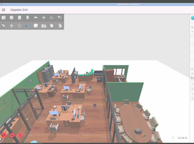

Furthermore, if I then try to source the setup.bash and run the simulation, Gazebo does open with a correct scene, but without the robot. The output after launching the simulation is as follows (after which an active shell prompt is give):
[INFO] [launch]: All log files can be found below /home/user/.ros/log/2025-06-10-14-07-45-423287-4_xterm-1801
[INFO] [launch]: Default logging verbosity is set to INFO
[INFO] [launch.user]: Robots:
[INFO] [launch.user]: Launching namespace= with init_pose= {'x': '0.0', 'y': '0.0', 'z': '0.2', 'roll': '0.0', 'pitch': '0.0', 'yaw': '0.0'}
[ERROR] [launch]: Caught exception in launch (see debug for traceback): "package 'controller_manager' not found, searching: ['/home/user/sim_ws/install/teleop_twist_keyboard', '/home/user/sim_ws/install/rosbot_xl_utils', '/home/user/sim_ws/install/rosbot_xl_gazebo', '/home/user/sim_ws/install/rosbot_xl', '/home/user/sim_ws/install/rosbot_xl_bringup', '/home/user/sim_ws/install/rosbot_xl_controller', '/home/user/sim_ws/install/rosbot_xl_description', '/home/user/sim_ws/install/ros_components_description', '/home/user/sim_ws/install/nav2_common', '/home/user/sim_ws/install/husarion_gz_worlds', '/home/simulations/ros2_sims_ws/install/rmw_cyclonedds_cpp', '/home/user/ros2_ws/install/dds_tests_pkg', '/opt/ros/jazzy']"

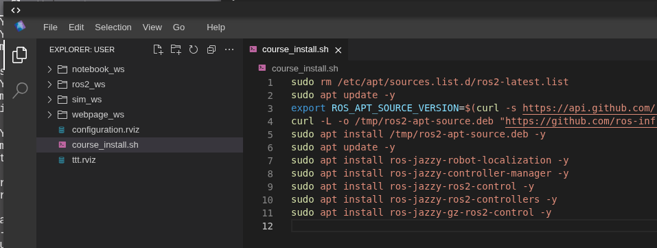

Have you added at the beginning of the course_install.sh a line updating the packages:
sudo apt update
I was running this via the virtual desktop like in the video, as I don’t have Linux environment at the moment. Also, I don’t have that much experience on Linux, so it seemed prudent to do it on the environment provided. I tried updating apt and then running the course_install script again, but that didn’t help.

e: and it seems the course install.sh does include the apt udate

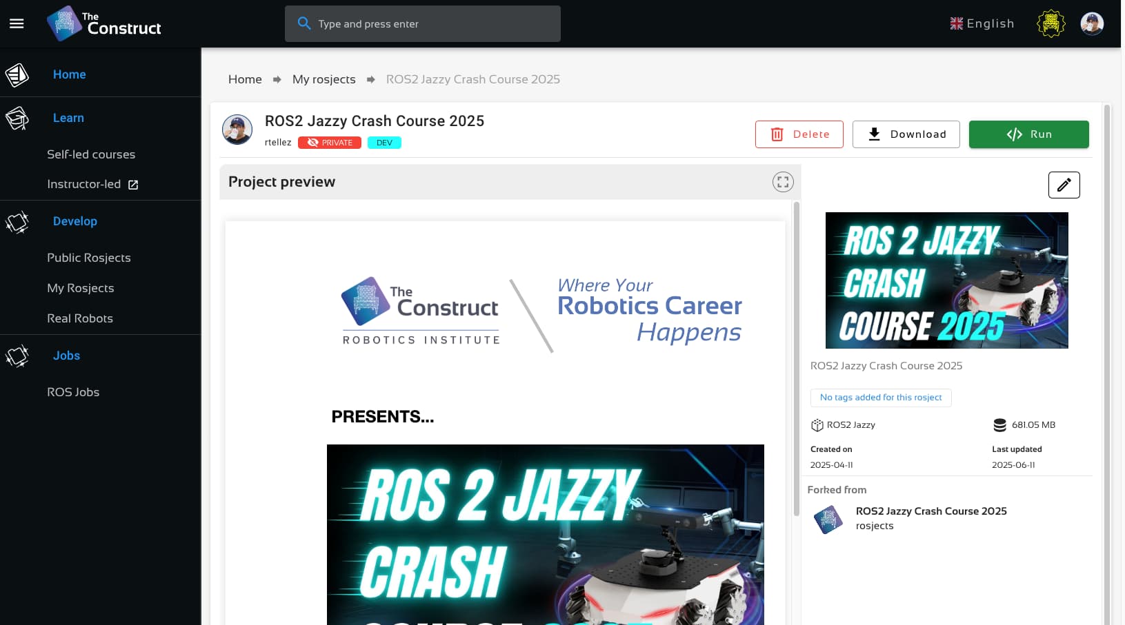

OK I see your problem and found where the error is. Please do the following steps to correct everything:

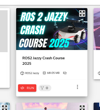

  1. Go to your list of rosjects (My rosjects) and click on the image of your Jazzy rosject to open all the options of the rosject
  1. Click on Deleteto delete the rosject. Delete it completely
  2. Click on this link to get a new and upgraded version of the rosject: https://app.theconstruct.ai/l/68e888b2/
That’s it. Your rosject will now work properly.
Let me know if you still have problems

output when I launch the simulation:
[INFO] [launch]: All log files can be found below /home/user/.ros/log/2025-06-11-12-04-26-918941-1_xterm-1339
Once again gazebo launches with the correct scene, but the robot is missing.
Sorry about that.
Please locate the course_install.sh file in the code editor and replace the content with this:
sudo rm /etc/apt/sources.list.d/ros2-latest.list
sudo apt update -y
export ROS_APT_SOURCE_VERSION=$(curl -s https://api.github.com/repos/ros-infrastructure/ros-apt-source/releases/latest | grep -F "tag_name" | awk -F\" '{print $4}')
curl -L -o /tmp/ros2-apt-source.deb "https://github.com/ros-infrastructure/ros-apt-source/releases/download/${ROS_APT_SOURCE_VERSION}/ros2-apt-source_${ROS_APT_SOURCE_VERSION}.$(. /etc/os-release && echo $VERSION_CODENAME)_all.deb" # If using Ubuntu derivates use $UBUNTU_CODENAME
sudo apt install /tmp/ros2-apt-source.deb -y
sudo apt update -y
sudo apt install ros-jazzy-robot-localization -y
sudo apt install ros-jazzy-controller-manager -y
sudo apt install ros-jazzy-ros2-control -y
sudo apt install ros-jazzy-ros2-controllers -y
sudo apt install ros-jazzy-gz-ros2-control -y
Then run the following on any terminal:
bash ~/course_install.sh
After this, you should be able to launch the simulation without any issues.
source ~/sim_ws/install/setup.bash
ros2 launch rosbot_xl_gazebo simulation.launch.py
