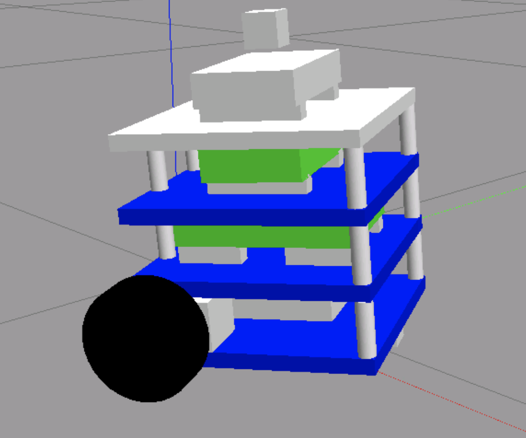

I am trying to build the tb3 burger from ROS2 URDF and am at a point where i have mostly completed unit 5 section but i cannot see the laser mesh in gazebo but i see as a cylinder when i rotate the laser. can you please check and point me to resolve this item ?

In rviz.

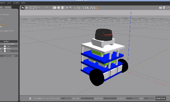

In gazebo

Thanks, i got the small issue in the #3 you highlighted above.
I am able to see the mesh in gazebo.
