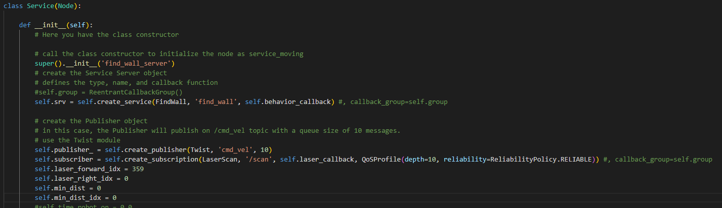

I see that you are already trying to introduce callback groups (although they are commented now) and that is the correct path to go down, in order for your program to be able to handle multiple callbacks.

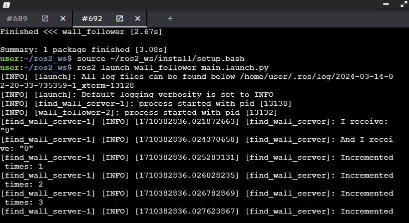

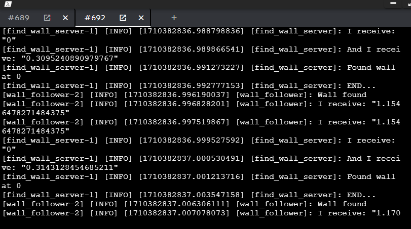

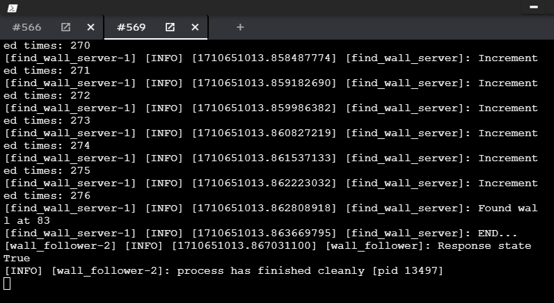

Thank you for clarifying the project, but that was not what I meant. However, I got the server to work in a proper manner, but I do not think it is the proper way to access it. It works for now, so I will leave it as is. Here is what I am talking about
You see how I used the Wall_Following() class twice. I am not sure why, but without lines 146 and 147, the rest of wall_follower.py does not start (shown below). With those lines, it goes straight into wall_following function.
Can anyone explain why this happens? For now I will just keep it like that since it works.
The problem I am facing now are the laser readings. I noticed that, in wall_finding.py, the indexing of the robot is different from when I used them for part 1 of the project. I setup the bot so that the left side is the closest to the wall. Instead, I get a different index which is always on the right side.
I am still working on the logic of the while loop, so for now, the bot moves at angular velocity of 2.0 in any direction depending if it is greater or less than front laser index. The problem here is that it should have detected the wall on its left side using min(msg.ranges). I think I used the laserscan wrong for part 1 of the project for simulation, yet it worked on the real robot. What am I missing or not considering? I did update the code just a little from the previous pictures, so if need be, I can post them again. (Also, laser_forward_idx = 359, just in case that is part of the problem)
