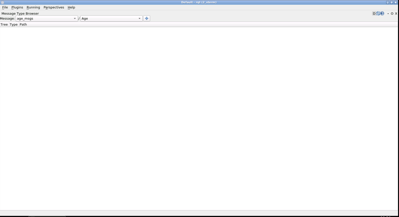

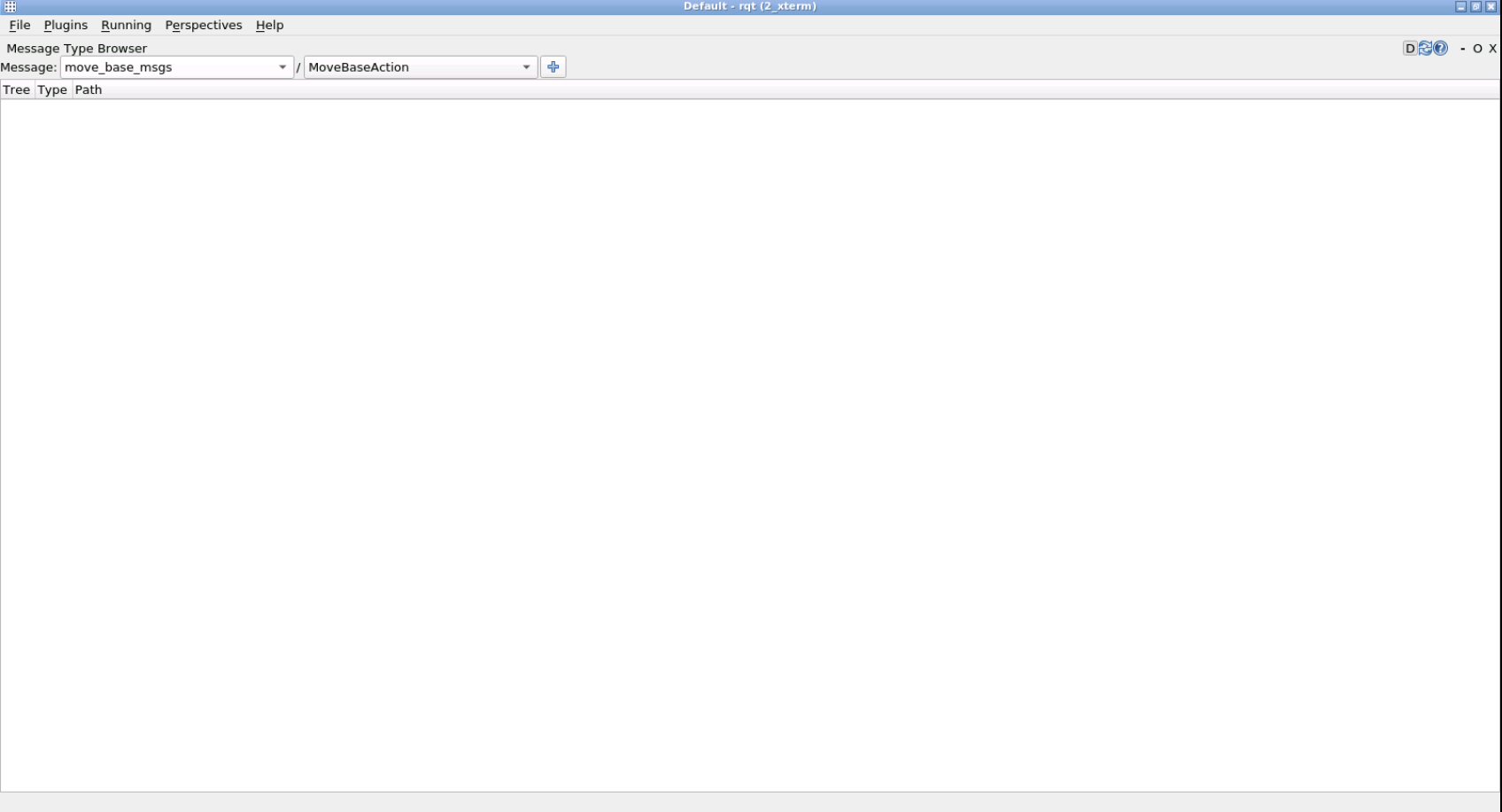

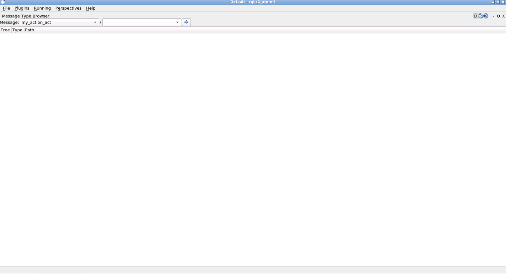

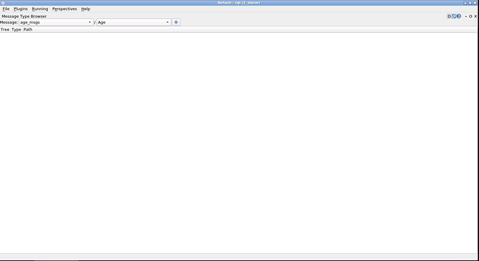

In rqt, other action, topic can see the message but my_action. @@

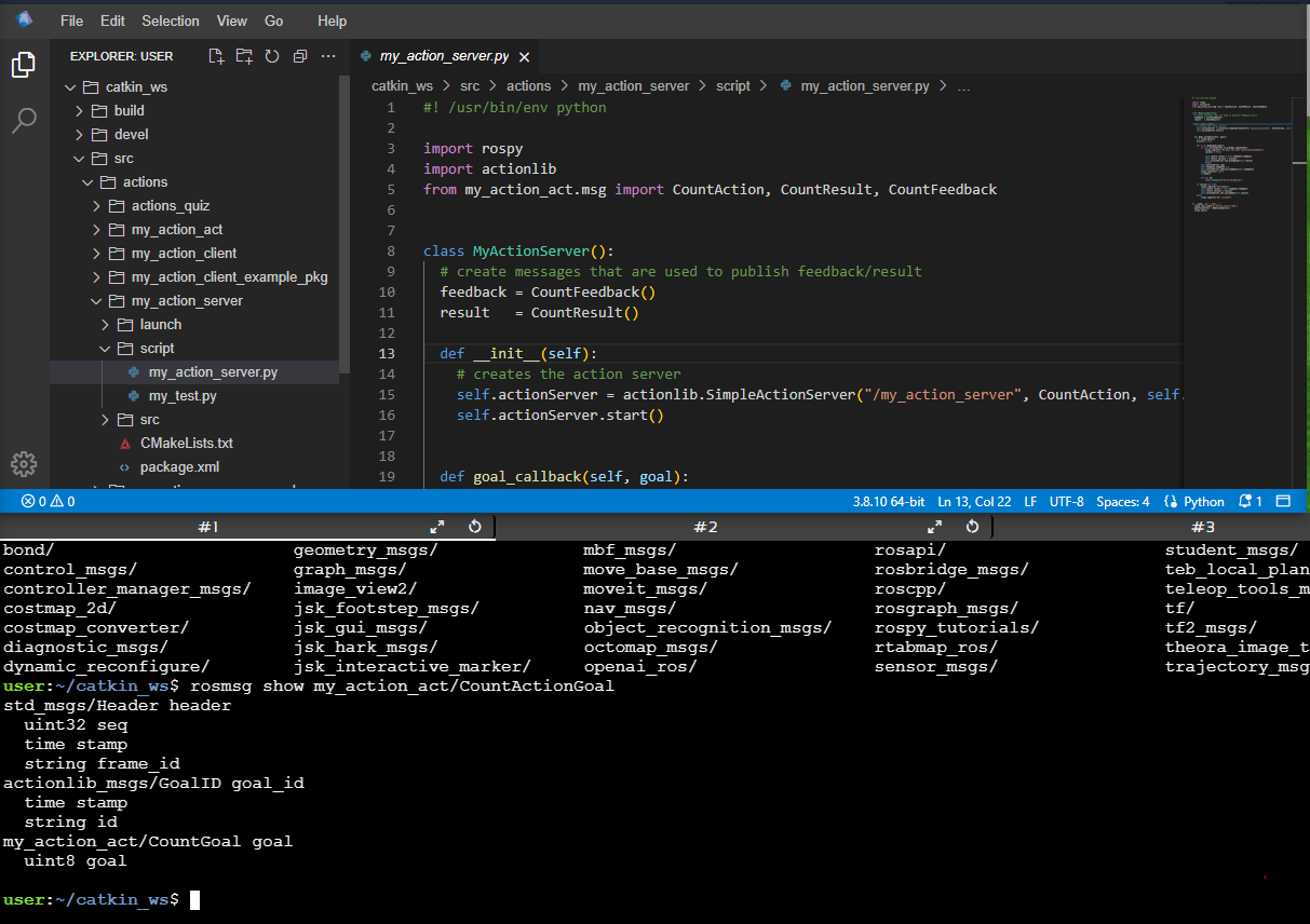

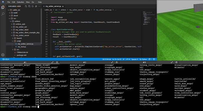

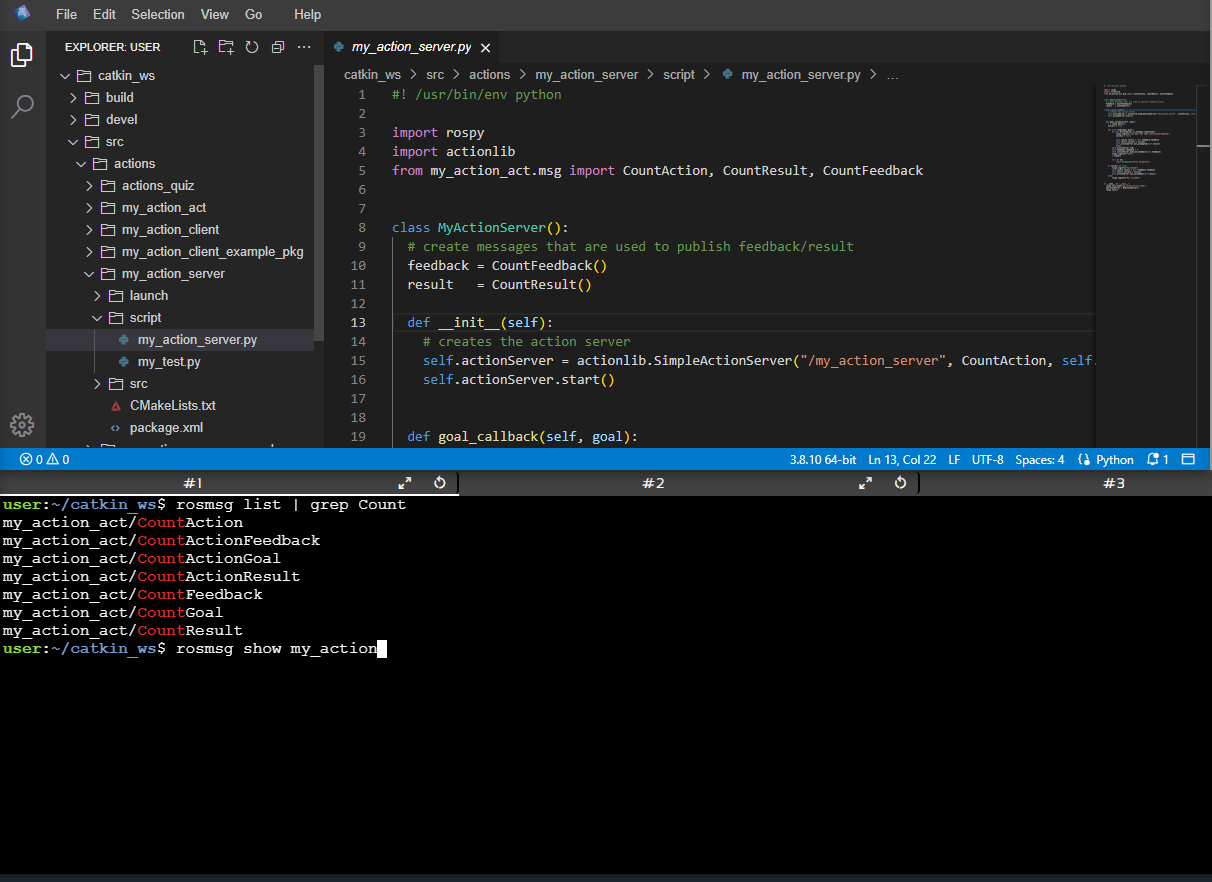

As you can see, I type:
rosmsg show [tab] [tab] …
it will list all packages and it does not have my_action_package
But I type rosmsg list | grep <my_action>, it still lists my messages normally
I do not understand this part. Could you please elaborate?

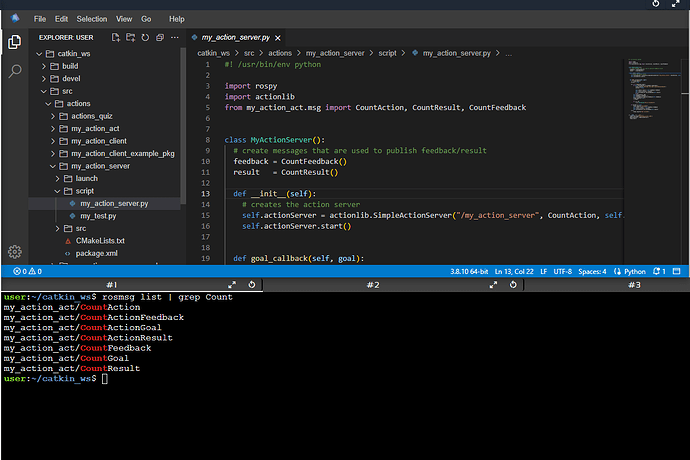

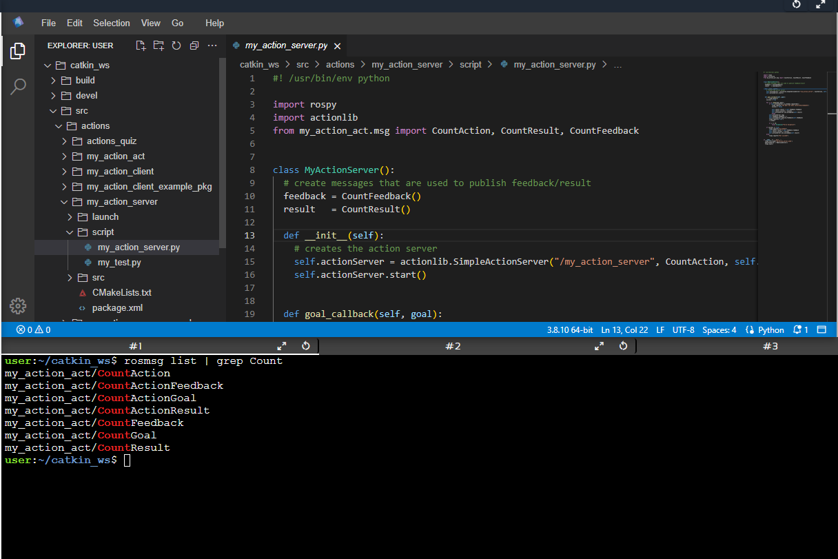

  1. I build my action message (CountAction) in a package (my_action_act) → catkin_make → source … : Done
    I type: rosmsg list | grep Count
    Terminal shows all my action messages

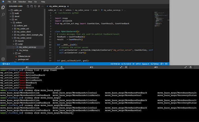

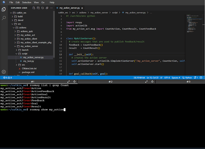

  2. I type: rosmsg show my_act [tab] [tab]… but it does not suggest or complete my message

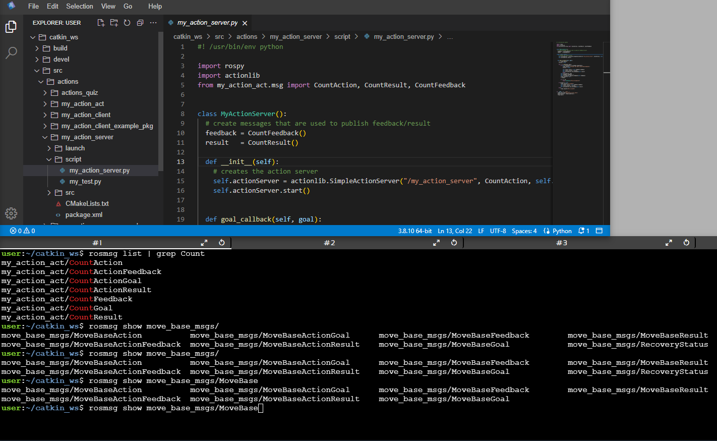

  3. I try: rosmsg show move_base [tab] [tab] … it works very well. It can suggest and complete the messages. It means I know how to use [tab] [tab] to complete message
=> My question is why ROS does not suggest and complete my action message. But It can suggest and complete move_base action message

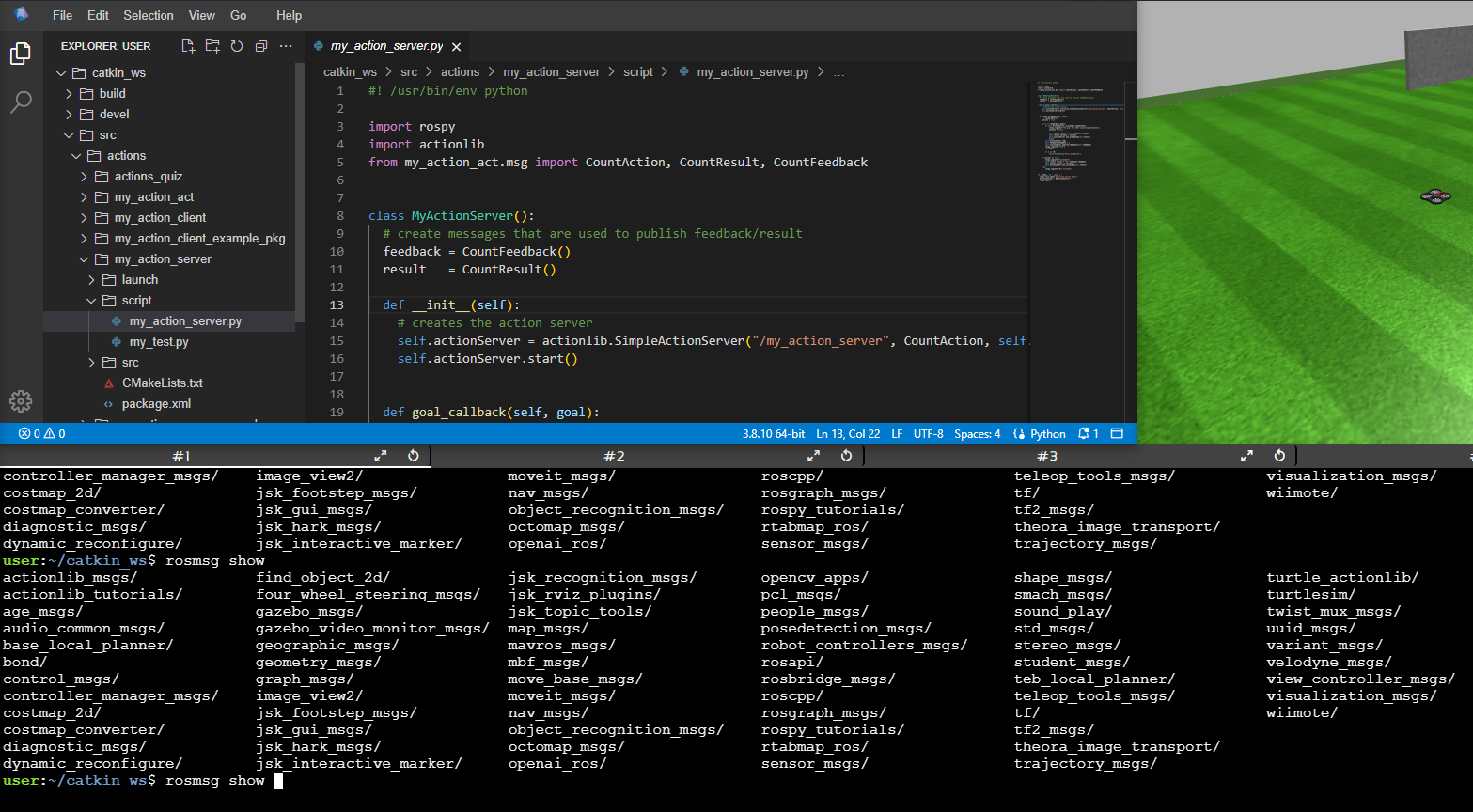

  1. I try to another way: rosmsg show [tab] [tab] → It will suggest all packages that contain messages. I see it has move_base_msgs package but it does not have my_action_act
=> Why is it? ^^
  1. I try to complete my action message manually. It works well.
=> So I think after I build my_action_act package to build message, it does not add my package into result of (rosmsg show [tab] [tab]) so it can not suggest and complete my command. But why?

user:~/catkin_ws$ source devel/setup.bash
user:~/catkin_ws$ rospack profile
Full tree crawl took 0.036312 seconds.
Directories marked with (*) contain no manifest.  You may
want to delete these directories.
To get just of list of directories without manifests,
re-run the profile with --zombie-only
0.031494   /opt/ros/noetic/share
0.003149   /home/simulations/public_sim_ws/src
0.002935   /home/simulations/public_sim_ws/src/all
0.001661 * /opt/ros/noetic/share/doc
0.001620 * /opt/ros/noetic/share/doc/eigenpy
0.001066 * /opt/ros/noetic/share/doc/eigenpy/doxygen-html
0.000353   /home/simulations/public_sim_ws/src/all/hector_gazebo
0.000323   /home/simulations/public_sim_ws/src/all/parrot_ardrone
0.000240   /home/simulations/public_sim_ws/src/all/variant
0.000212   /home/simulations/public_sim_ws/src/all/robot_controllers
0.000189 * /opt/ros/noetic/share/doc/eigenpy/doxygen-html/search
0.000138   /home/simulations/public_sim_ws/src/all/actionlib
0.000120   /home/simulations/public_sim_ws/src/all/turtle_3d
0.000118   /home/user/catkin_ws/src
0.000113   /home/simulations/public_sim_ws/src/all/worlds_tc
0.000110   /home/simulations/public_sim_ws/src/all/simulation_gazebo
0.000108   /home/simulations/public_sim_ws/src/all/spawn_robot_tools
0.000092 * /opt/ros/noetic/share/ament_index
0.000087   /home/simulations/public_sim_ws/src/all/person_sim
0.000081   /home/simulations/public_sim_ws/src/all/openai_ros
user:~/catkin_ws$ rosmsg list | grep Count
my_action_act/CountAction
my_action_act/CountActionFeedback
my_action_act/CountActionGoal
my_action_act/CountActionResult
my_action_act/CountFeedback
my_action_act/CountGoal
my_action_act/CountResult
user:~/catkin_ws$ rosmsg show
actionlib_msgs/             four_wheel_steering_msgs/   jsk_rviz_plugins/           pcl_msgs/                   smach_msgs/                 twist_mux_msgs/
actionlib_tutorials/        gazebo_msgs/                jsk_topic_tools/            people_msgs/                sound_play/                 uuid_msgs/
audio_common_msgs/          gazebo_video_monitor_msgs/  map_msgs/                   posedetection_msgs/         std_msgs/                   variant_msgs/
base_local_planner/         geographic_msgs/            mavros_msgs/                robot_controllers_msgs/     stereo_msgs/                velodyne_msgs/
bond/                       geometry_msgs/              mbf_msgs/                   rosapi/                     teb_local_planner/          view_controller_msgs/
control_msgs/               graph_msgs/                 move_base_msgs/             rosbridge_msgs/             teleop_tools_msgs/          visualization_msgs/
controller_manager_msgs/    image_view2/                moveit_msgs/                roscpp/                     tf/                         wiimote/
costmap_2d/                 jsk_footstep_msgs/          nav_msgs/                   rosgraph_msgs/              tf2_msgs/
costmap_converter/          jsk_gui_msgs/               object_recognition_msgs/    rospy_tutorials/            theora_image_transport/
diagnostic_msgs/            jsk_hark_msgs/              octomap_msgs/               rtabmap_ros/                trajectory_msgs/
dynamic_reconfigure/        jsk_interactive_marker/     openai_ros/                 sensor_msgs/                turtle_actionlib/
find_object_2d/             jsk_recognition_msgs/       opencv_apps/                shape_msgs/                 turtlesim/
