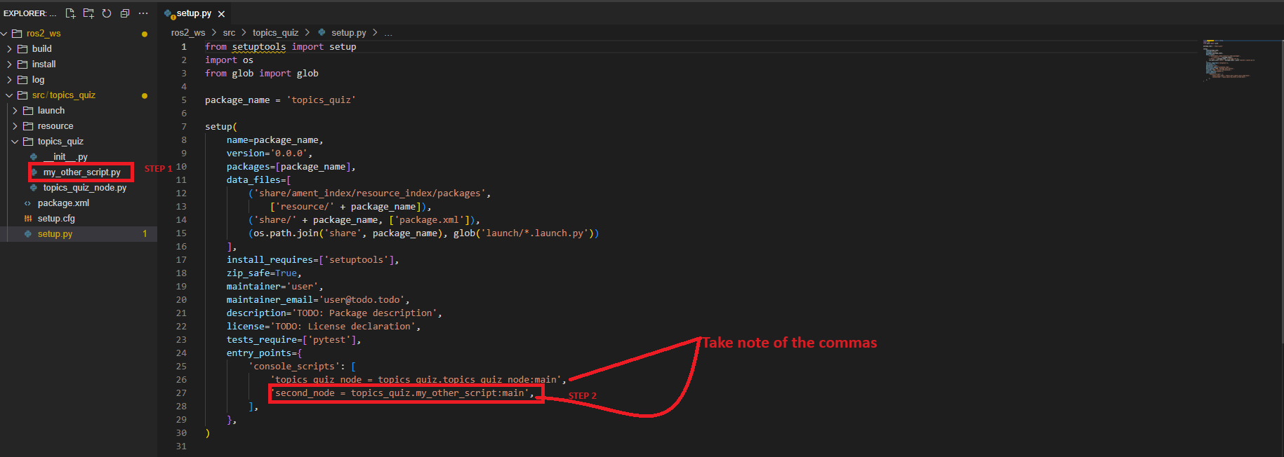

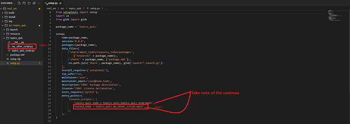

You can include other files in the console_scripts section of the setup.py file, as indicated in the image below:
  1. Create the other script(s) beside your main script.
  2. Add another entry (or entries) for the extra scripts in the console_scripts array.
PS: I think it’s named “console scripts” because we can have two or more scripts there :slight_smile:
After adding new scripts, you need to recompile:
cd ~/ros2_ws
rm -rf build/ install/ log/
colcon build
source install/setup.bash
