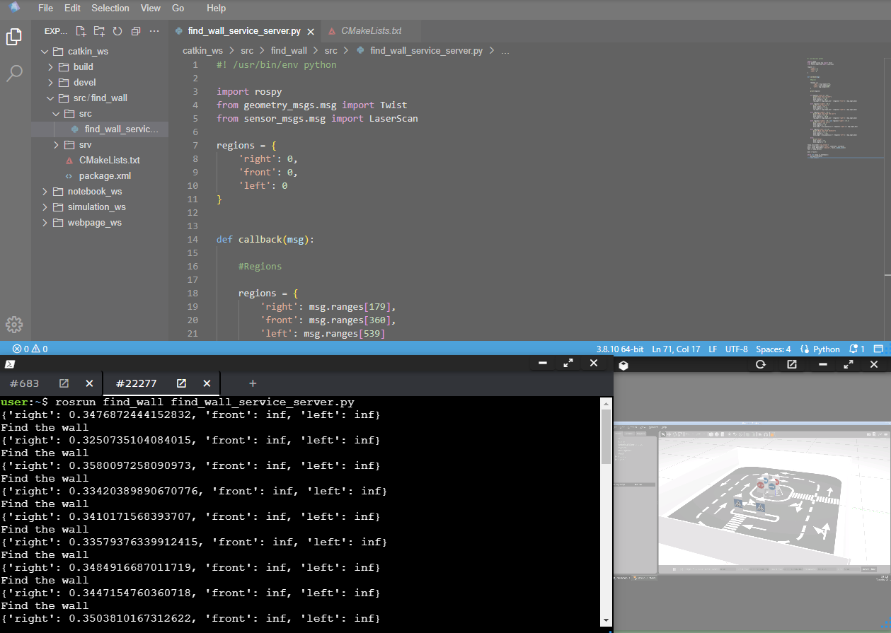

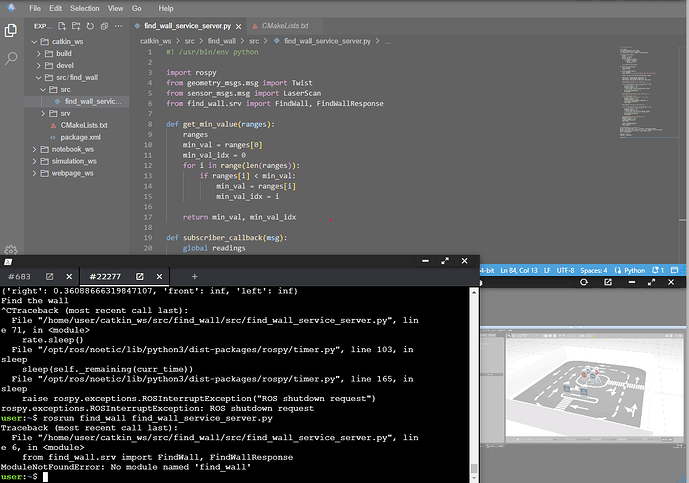

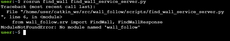

Hello everyone.
I am having a hard time on the Section 2 of Course Project of ROS Basics (Python).
I wanted to run my python script before creating a service server launch file. I always used rosrun package_name python_script_name to make it work.
But I seem to be missing something for this Section 2 because it doesn’t work.

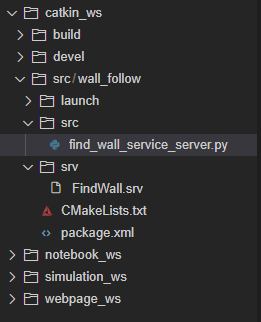

Here is how my IDE looks like (no launch files because I am just at the begining and already in difficulty) :
A list of a few things that I did to make run correctly :
- catkin_make and source devel/setup.bash once I edited my CMakeList.txt and package.xml
- checked the rossrv list
- delete build and devel from the catkin_ws repertory and
rm -rf build/ devel/thencatkin_makeandsource devel/setup.bashagain
