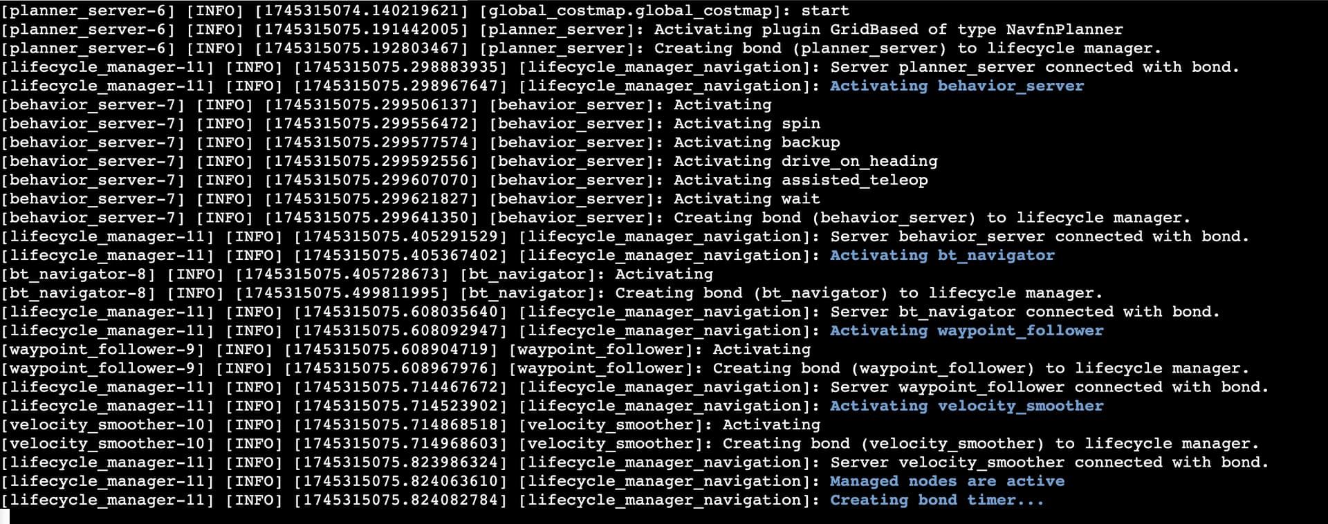

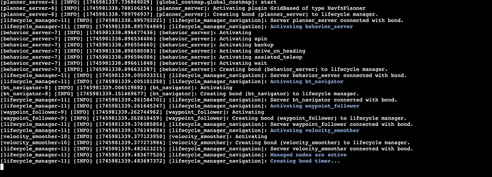

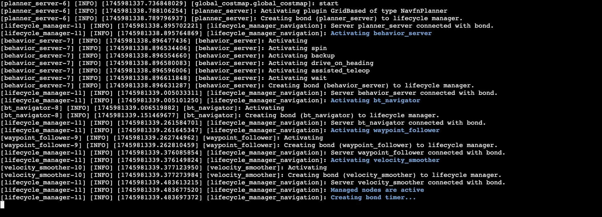

Based on your screenshot, I think you meant to post this under ROS2 Navigation Humble - The Construct ROS Community. Please keep in mind while asking for help in the forum, it helps us compartmentalize.
Usually the lifecycle_manager_navigation
node log Managed nodes are active
means everything launched correctly, so it is strange that the robot is not responding. Could you provide a little more context, as well as rviz
with the appropriate configuration? Another screenshot would be great.
Does sending a goal through rviz
work after launching Nav2?

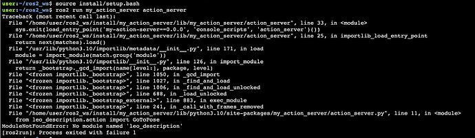

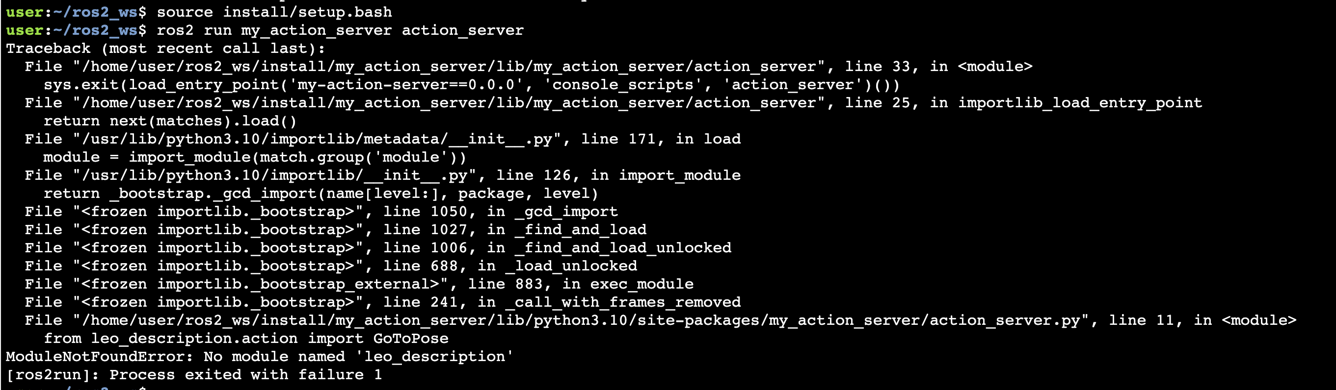

source /home/simulations/ros2_sims_ws/install/setup.bash
This should help with the leo_description
part of the module not found
error.

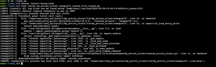

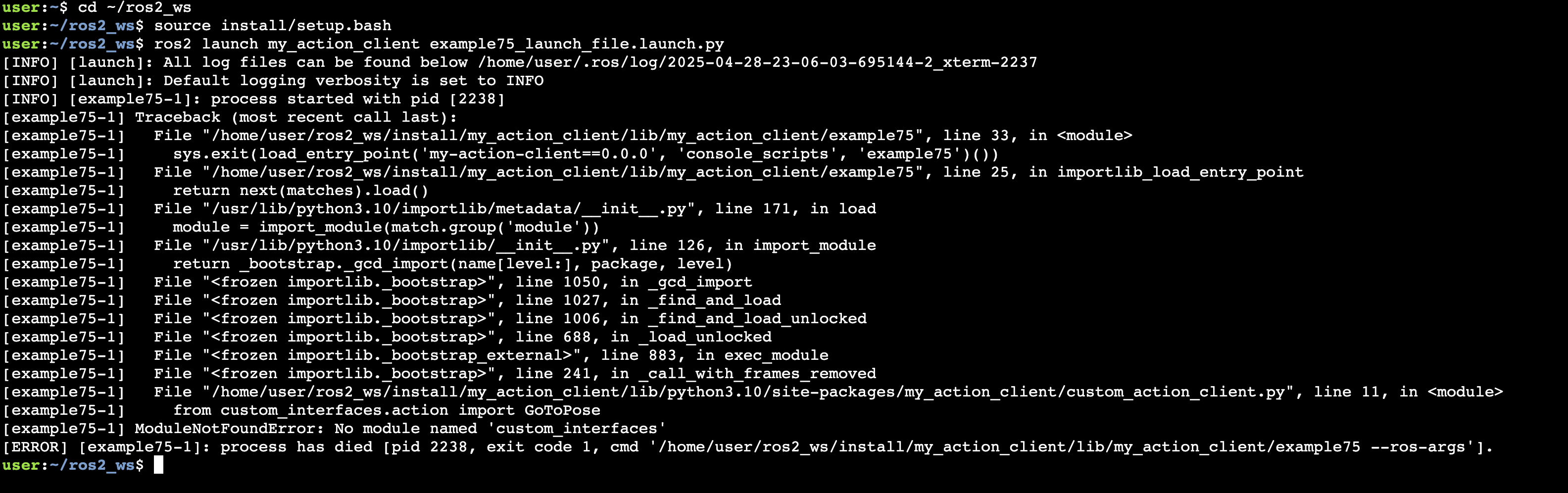

The custom_interfaces
error indicates that the package could not be found in your workspace, and it’s a dependency of the package you are trying to launch.

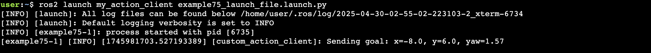

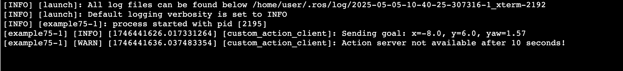

Hi @bayodesgun,
I have recently fixed the custom_interfaces problem but having said so, I am having this problem with Terminal #1. it seems like whatever command that I have sent from Terminal #3, ros2 launch my_action_client example75_launch_file.launch.py
does nothing. Could you help me understand why is this the case? When I pressed Ctrl+C, it seems like it has a problem with this line:
self._action_client.wait_for_server()
Terminal #1:
Terminal #3:

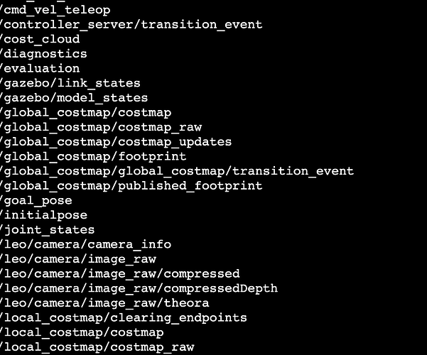

I did a bit of my own debugging and it seems like the action server is not available.
Sorry for the delayed response.
Things you can check, in order:
- Before starting the client on Terminal 3, ensure you run
- Run
ros2 topic list
and confirm the action topics are present.- If not, please check that your action server is properly written
- Check that your action client is properly written, following the examples given in the notes

Is it because I have sourced the bash codes from different origins?
I can’t seem to find the go_to_pose node either
You did not state the specific issues you are still having, so I don’t know how to help.
If you’re expected to import GoToPose
from leo_description.action
, then you need to source the two workspaces on the terminal where you want to run the code:
source `/ros2_ws/install/setup.bash
Hi @bayodesegun,
unfortnately the GoToPose node is not available despite having sourced the two workspaces stated
The main issue is that the code from Terminal #3 (Client code) was unable to find the server. Here is the output after modifying the example code slightly using ChatGPT.
It seems like the ActionClient node is not communicating properly
I dont know what specifically the issue is but it seems to be with regards to this line self._action_client.wait_for_server()
