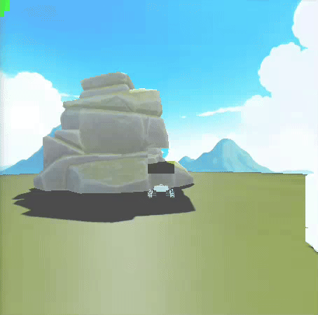

I also compared my turn with the gif you have above and they look similar
Course simulation - ROS2 Basics in 5 Days (Python) _ Robotics & ROS Online Courses _ The Construct - Screencastify - September 9, 2025 7_35 AM (3)
One thing is that it work when you executed using your own server an dthe other is executing it with the server of the grader.
When you execute teh grading doesn the robot turn? I knwo its a bit difficult to see becuas eteh simulation window gets blurred but you cn see that its turning.
I say this becuase I see that you are using “RIGHT” instead of “right”. This would make teh server NOT work or turn the other way round, becuas ethe server does this:

Hello,
I changed my client to send over lowercase “right” and I saw that it did perform the turn in the simulation during the grading process, but I am still obtaining the same error. Also I was wondering if it would be possible to add more attempts to the grader so I can continue to debug (I ran out).
Let me check deeply this issue becuase it make no sense that you don’t get the correct grades. If you tell me I can erase those grades an dyou can retry 5 times more
Please let me know
Hi, Sorry for the late reply. We made a ne version for the correction script that is more robust to any slight difference in coding. Now your service quiz passes with a 10 and we updated your grade . Sorry again for the inconvenience.
