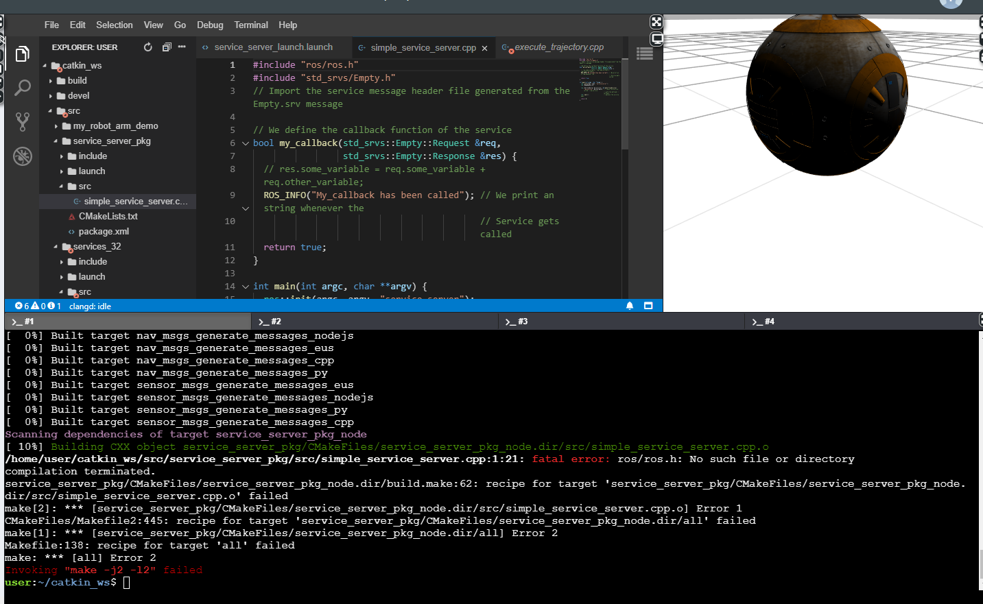

Services Server fatal error: ros/ros.h: No such file or directory
I am trying to complete Ex. 3.3 in the service server section. And I am getting this error fatal error: ros/ros.h: No such file or directory. I know it is likely an issue with my make file.
Do I need to do anything with the generate messages portion of the make file?

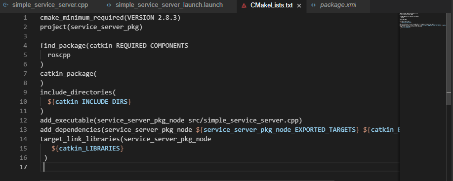

So I am just confused about what changes need to be made to the makefile and Launch, because that is where the error is from I think. The purpose of this assignment is to start a simple service server with an empty service.
For the makefile, do I need to do anything beyond the typical lines to add executable, dependencies and links?
For the launch file do I need to add a line like the one that is commented out?

Looking at the solutions for Ex. 3.4 make make and launch files do seem correct. I have included an image of the full error output, the cpp file and the xml file.
Solution:
The issue I think was coming from the make file: Line 13, inside first curly brace should have been {simple_service_server_EXPORTED_TARGETS}
