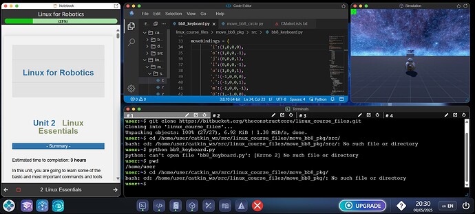

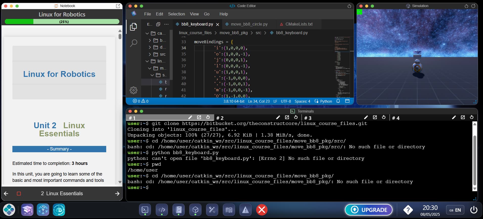

Simulator not working
try many times but bb2 not working even file not in directory.
@paramvirk
It appears that you cloned the repository into the incorrect directory.
You should run cd /home/user/catkin_ws/src (equivalent to cd ~/catkin_ws/src) before running the clone command.
