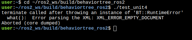

I’m getting this error after updating test_unit4.cpp lines 214-225 match the solution:
user:~/ros2_ws/build/behaviortree_ros2$ ./test_unit4
terminate called after throwing an instance of ‘BT::RuntimeError’
what(): Error parsing the XML: XML_ERROR_EMPTY_DOCUMENT
Aborted (core dumped)

I’m receiving this error in the “ROS2 Simulation” section (after exercise 4) in Unit 4 of Behavior Trees. I updated ~/ros2_ws/src/bt_course_files/behaviortree_ros2/test/test_unit4.cpp with the solution code in lines 214-225:

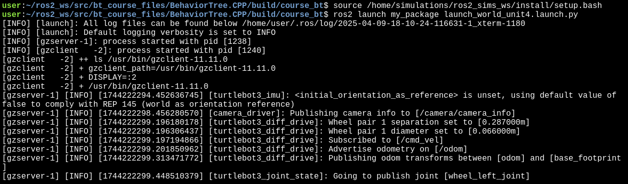

Then I started the simulation in one terminal:
Then in a second terminal I run test_unit4 and receive the following error:

  2. then I source /home/simulations/ros2_sims_ws/install/setup.bash and start the simulation successfully
  3. then I run ./test_unit4 and receive the same error (“Error parsing the XML”)
I see. I still think test_unit4.cpp is not being rebuilt. It looks like it’s not in the package you are overriding. You can verify that the timestamp of test_unit4 in the build directory changes when you rebuild.
As a last resort, can you try removing build and install and rebuilding everything again?
