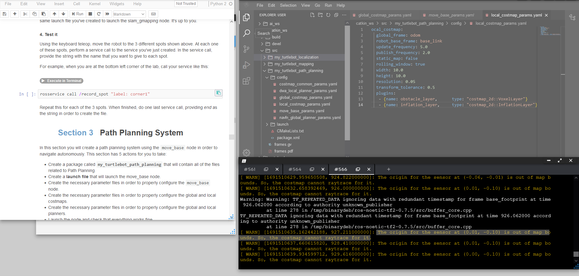

Can anyone help to solve this? I’m coursing the Navigation Real Robot Project and I’m trying to path planning i made all the required settings but its keeps showing this error.

Have you provided a proper initial position in Rviz, so the localization localizes properly the robot inside the map?
I have not, could you explain me how to?
Does you refer to the 2D Pose Estimate tool?
if you referring to it, yes i dit it, and nothing change
