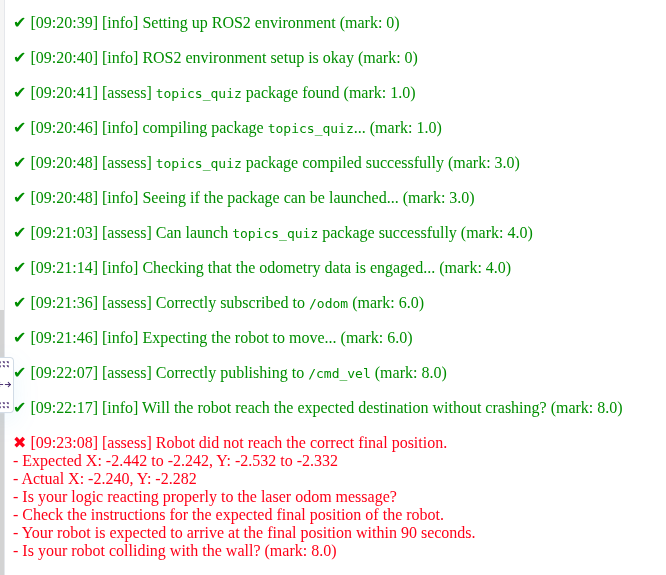

I have a problem in 3.10 Topics Quiz. I have received the same feedback two times. I have used the ros2 node info /topics_quiz to make sure that the \odom is subscribed, as you can see in the attached screenshot.

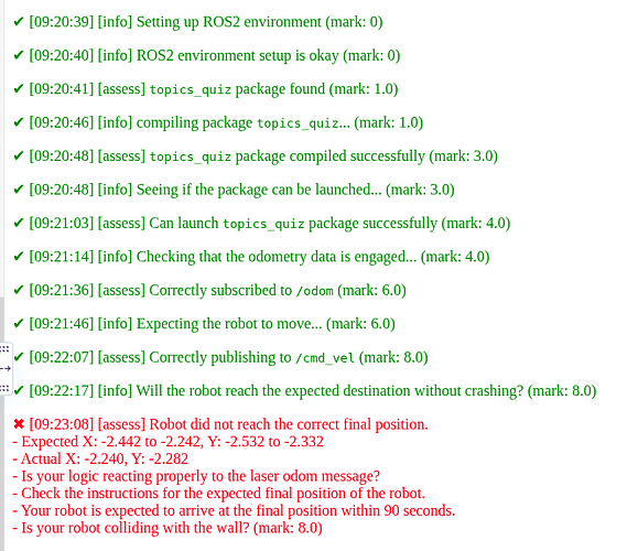

Have you fixed that issue? Because form the tests I’ve done seems that your mark is 8, because the position of the robot at the end is a bit off of what is asked.
No, same issue.
I had the mark 8 in the second trial. Then I decided to modify the navigation section only. Now, my script works perfectly, but I have the mentioned feedback from the grading bot, and I have 4 out of 10. The grading bot says each mark is overwritten on the last one, so I have 4, and there is only one submission left.
Your current score is 8, as per your latest submission, and you have the following feedback.
I have assigned you two more trials to fine-tune the final part.
