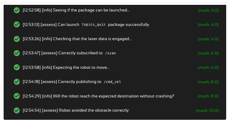

The grader bot cannot seem to find the topic_quiz package while i can run the simulation and can find the package using ros2 pkg list. Can you please help here ?
Hello, i can see the package in the topics and i am able to run the simulation correctly but the grade bot cant find it. can you pls help here ?

hello @girishkumar.kannan
Thanks for spotting that… Since the rest of the guide was topic_ i subconciously created it topic_quiz.
i crossed the unit.
