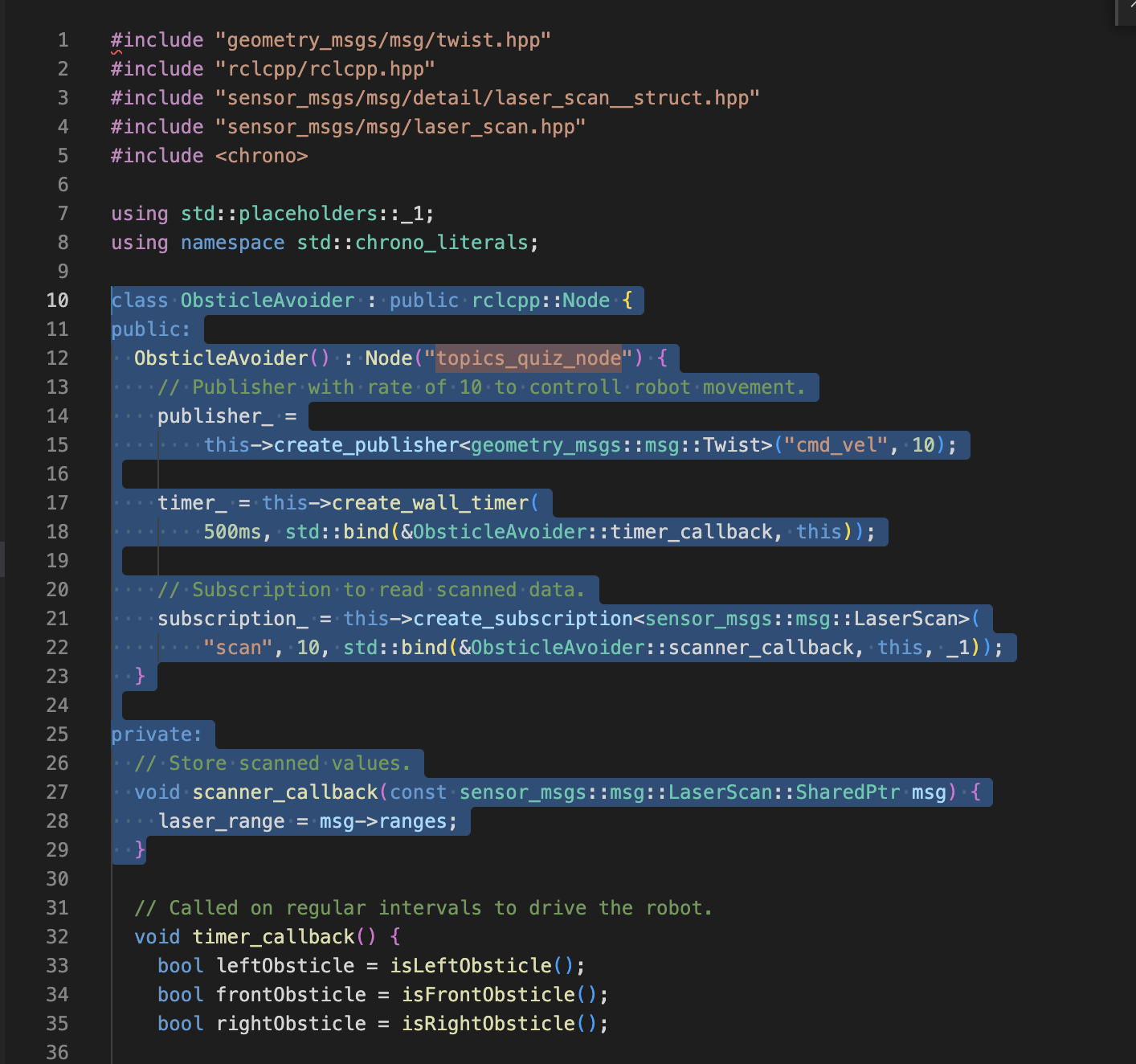

I believe the quizing system is failing me today with incorrect findings. After I corrected my mistake at 8.0 score yesterday I re-run and failed today due to:
:heavy_multiplication_x: [08:18:54] [assess] Not subscribed to /scan. I had big plans for this!
I know that I had not touched anything related to subscription code hence I re-run the quiz again right away and failed at the different step:
:heavy_multiplication_x: [08:29:06][assess] Not publishing to /cmd_vel. We can’t continue like this.
Here is my command line output for my node being subscribed to “/scan” topic by my node “topics_quiz_node”.

The problem here is that there’s something in your topics quiz node logic causing a segmentation fault (a C++ hard nut) to happen at random. I would start with the most recent change and check for what it could be.
The error in the logs is:
[ERROR] [topics_quiz_node-1]: process has died [pid 1544, exit code -11, cmd '/home/user/ros2_ws/install/topics_quiz/lib/topics_quiz/topics_quiz_node --ros-args'].
  • Code -11 is SIGSEGV.
The error started happening right from the 2nd attempt, after you made changes to fix the first not subscribed to /scan failure at the first attempt.
I’ve added 3 more trials for you, so you can take your time to fix this problem.
I have tweaked the code a little bit and passed on the next the try. Thank you again for your response.
