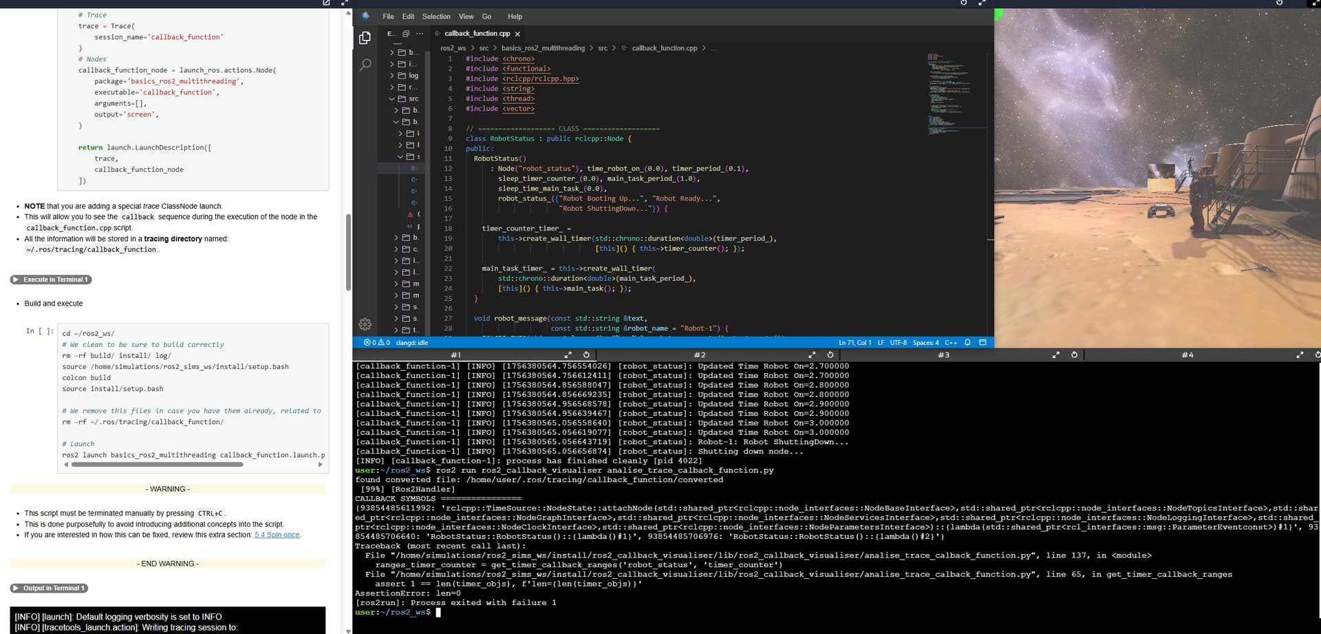

It seems that it cannot find the callback functions, maybe due to the use of bind()? I have now also tried with lamdas but I get the same error when calling the trace function.
Can you try to run this exercise using the handed out code to see if it works on your PC with the trace function?
See screenshot
Compile error:
CALLBACK SYMBOLS ================
{93854485611992: ‘rclcpp::TimeSource::NodeState::attachNode(std::shared_ptrrclcpp::node_interfaces::NodeBaseInterface,std::shared_ptrrclcpp::node_interfaces::NodeTopicsInterface,std::shared_ptrrclcpp::node_interfaces::NodeGraphInterface,std::shared_ptrrclcpp::node_interfaces::NodeServicesInterface,std::shared_ptrrclcpp::node_interfaces::NodeLoggingInterface,std::shared_ptrrclcpp::node_interfaces::NodeClockInterface,std::shared_ptrrclcpp::node_interfaces::NodeParametersInterface)::{lambda(std::shared_ptr<rcl_interfaces::msg::ParameterEventconst>)#1}’, 93854485706640: ‘RobotStatus::RobotStatus()::{lambda()#1}’, 93854485706976: ‘RobotStatus::RobotStatus()::{lambda()#2}’}
