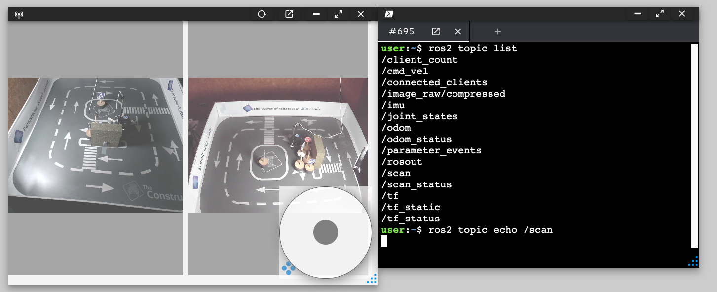

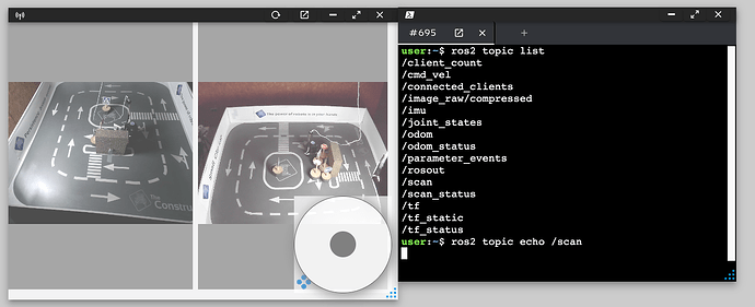

TurtleBot 3 Robot no Laser scan data
Connected to TurtleBot 3 robot for ROS2 basics Checkpoit 5 masterclass. No data on /scan topic
Hi @sarala1.ravindra let me take a look right now. Two questions, were you able to move the robot around? and were you able to see if the lidar on top of the robot was spinning?
@sarala1.ravindra the robot is functional please connect to it and try again
