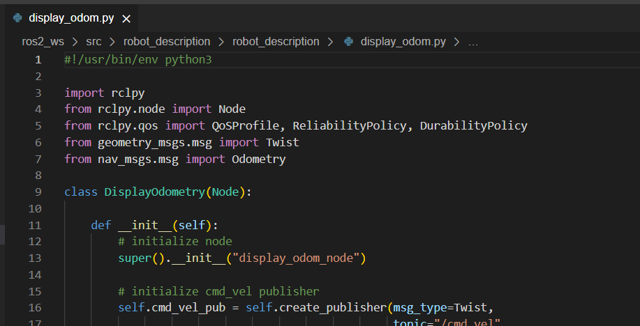

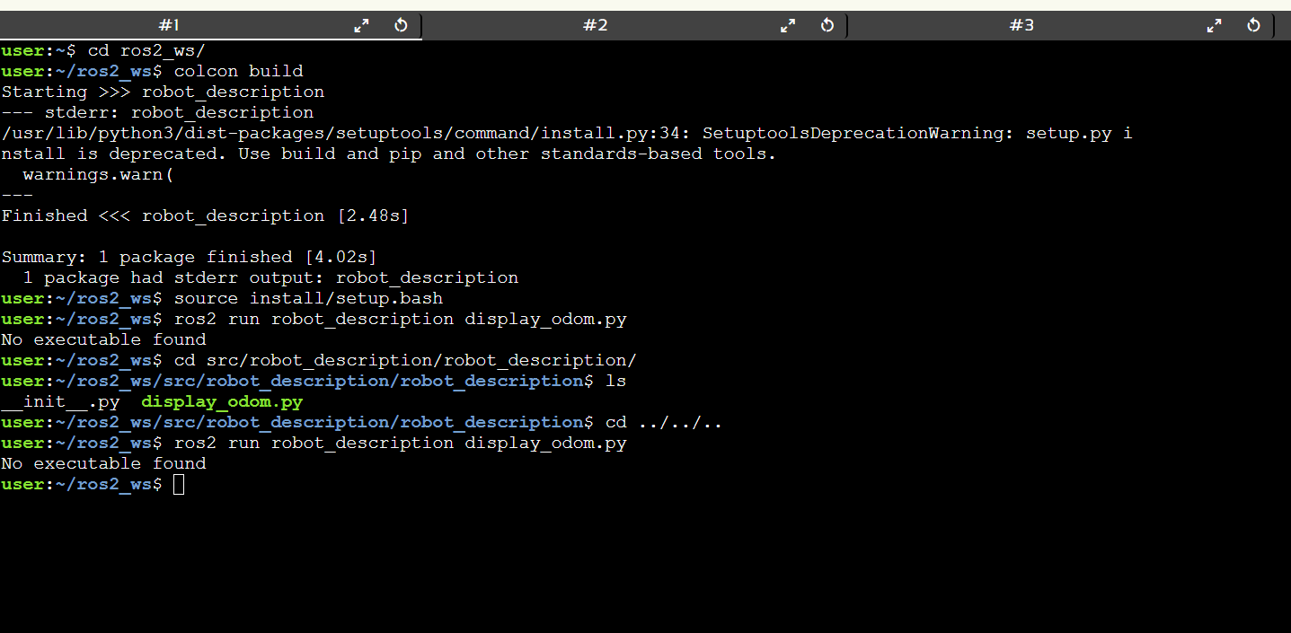

Unable to execute file - display_odom.py
I am sorry, this should be so easy.
I thought I created an executable file in the proper location. I did take the easy path of coping your code.
Thanks
I found the problem - forgot to update setup.py WOW I feel good the robot moves!!!
