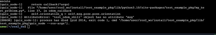

I am unable to understand the error message. I # the code lines that make the robot move parallel to wall at start, but cannot make it do the 90 degree turn. If someone could help would appreciate it

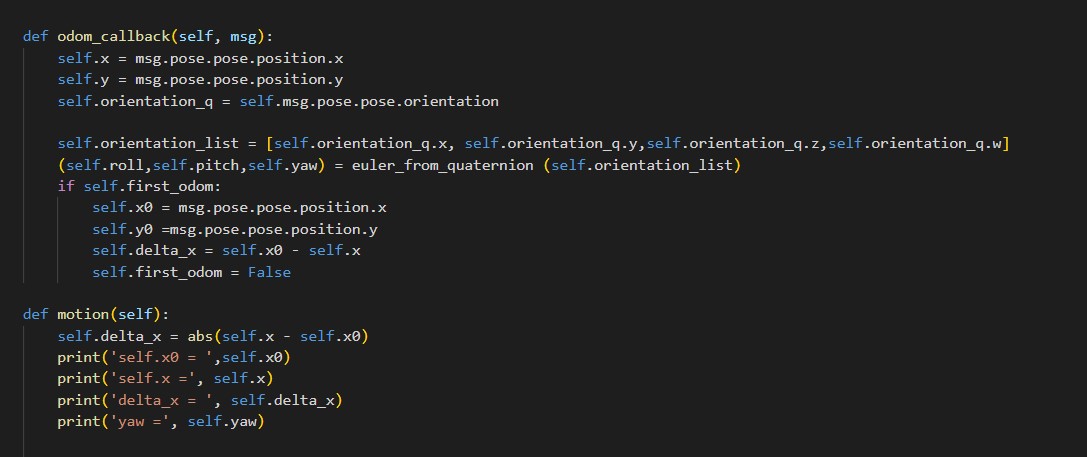

In your odom_callback function, in the third line:
self.orientation_q = self.msg.pose.pose.orientation has issues.
msg is not a class variable of your class test_odom_skill.
Therefore you get the following error:
AttributeError: 'test_odom_skill' has no attribute 'msg'.
Solution: Remove the self. and make the line as following:
self.orientation_q = msg.pose.pose.orientation.
That should fix this issue.
The error reported is quite straight forward!
