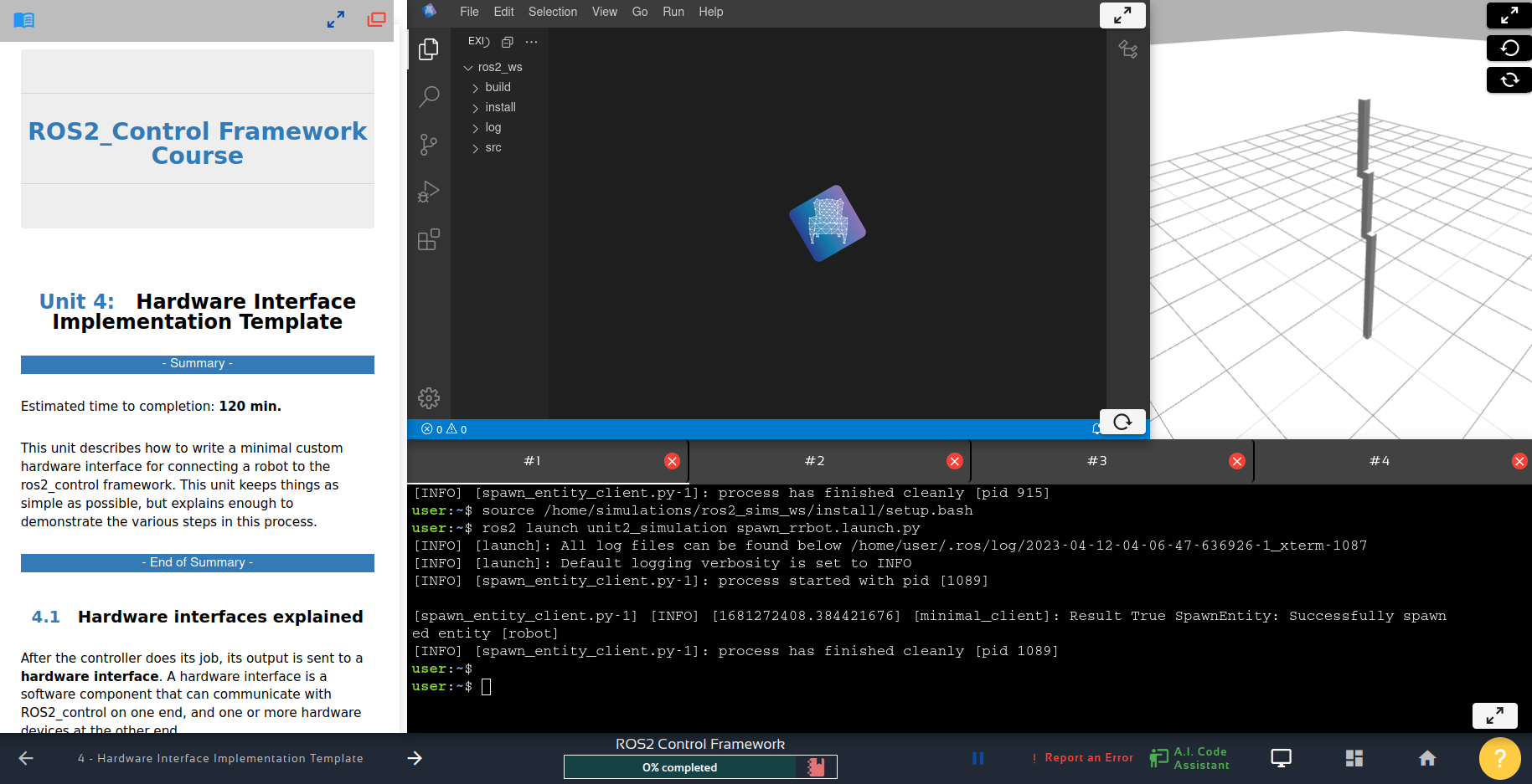

The robot appeared now.

I have taken the screenshot with the first two commands as followed in the above reply:
ros2 control list_controller_types
ros2 control list_controllers
These commands are executed right after the spawning robot commands:
source /home/simulations/ros2_sims_ws/install/setup.bash
ros2 launch unit2_simulation spawn_rrbot.launch.py
Also, I see nothing said about spawning the robot on our own
Hello @PhongNguyen,
this units assumes that you have completed the previous unit and requires you to spawn the robot using the files that you created in the previous unit. If you did so, you should be able to run the commands and see the expected results.
I have added new additional instructions to spawn the robot from the previous unit to make it clear.
Please confirm if you are seeing the expected results now.
