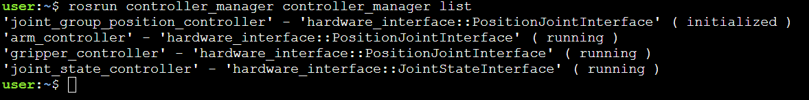

Apparently, the error message indicates that the controller is not loaded properly. And I can’t see anything related to controller from your launch file.
Could you please share the code snippet or configuration file related to controller, along with the result of the following command?
rosrun controller_manager controller_manager list
This command will show the list of controllers you configured.
In the configuration file, arm_group_controller is defined to control the joints, but it is not included in the list of controllers. Instead, arm_controller is present in the list. I assume you are loading controllers from another configuration file.
Which launch files do you run before launching MoveIt? Could you share those launch files, or provide a link to your Rosject?
