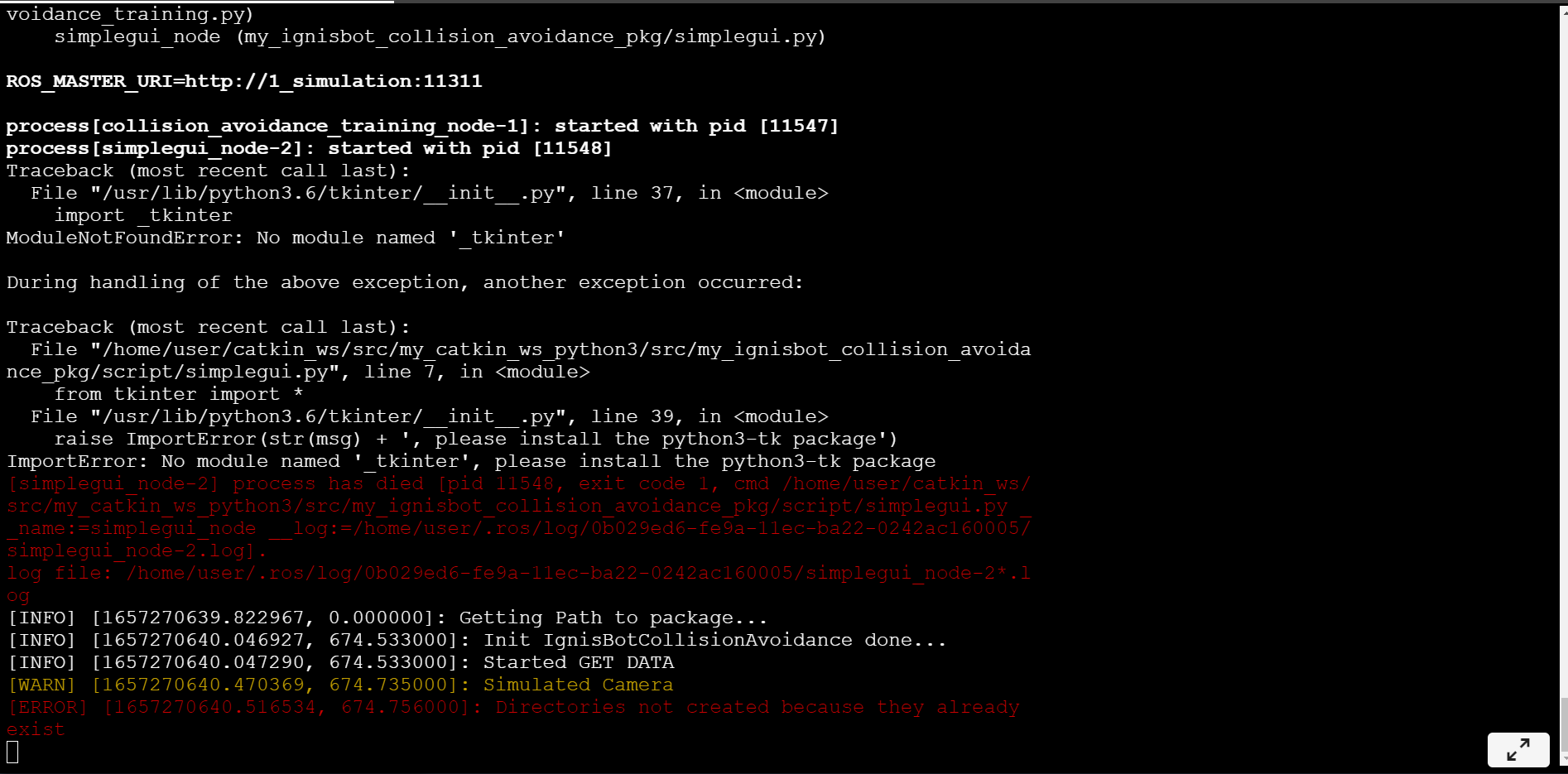

when i want to excute the Command : roslaunch my_ignisbot_collision_avoidance_pkg start_collision_avoidance_data_collection.launch
i have this problem

when i try to excute it, i get this problem:

it looks like a package is missing in the system (python3-tk). It should be installed by default.
Let us check why is this happening and come back with the solution.

In any case, all that is just for information purposes and for letting you better understand how the training system is working. Hence, the error you are experiencing is not due to your lack of issuing that command, but because there is a missing library in the system.
We are correcting this problem right now and come back to you when installed again.
