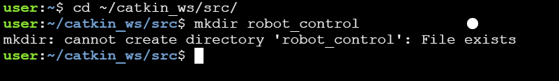

What is purpose of error . can you explain it

The error means that the directory you are trying to create already exists in the current location. So, instead of mkdir robot_control, run cd robot_control.
